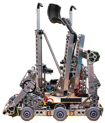

A linear slide mechanism like this robot has could work, or maybe a conveyor belt system

for yall considering a turret, maybe you can consider a design like this (by 971 in FRC): FRC 971 Spartan Robotics 2022 Reveal Video! - Robot Showcase - Chief Delphi
a design like this also makes it pretty easy to add a second (or third, or fourth) intake which can be pretty amazing in this game

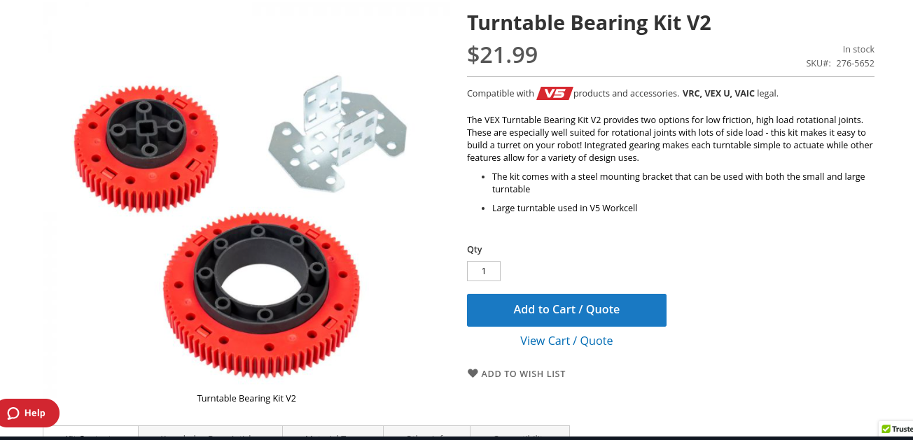

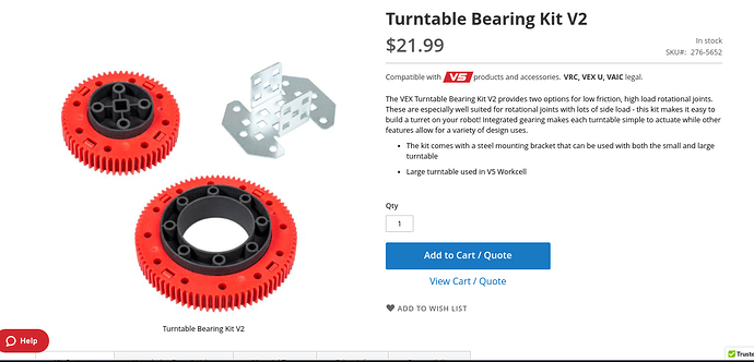

Are these going to generally be used for turrets or is a custom made piece going to be better?
Here’s the actual link (Turntable Bearing Kit V2 - VEX Robotics)
(Notice how it says that this kit is perfect for building a turret on your robot.)
