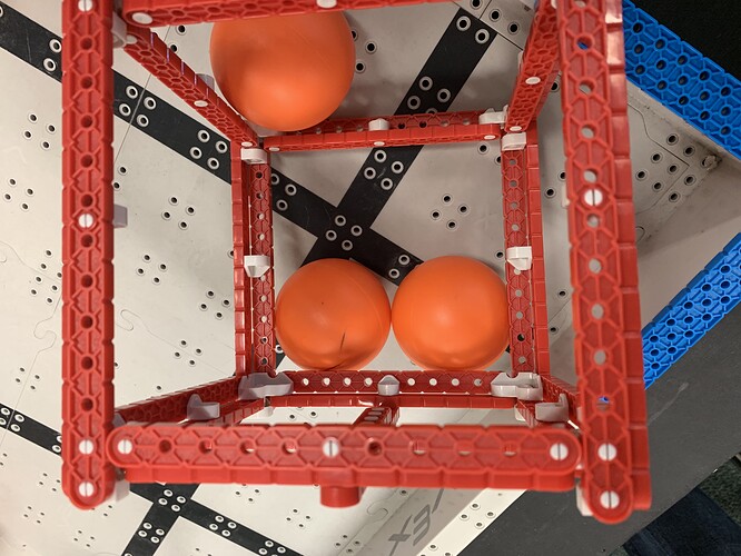

This actually happened today. SUMMER CAMP 2019!!!
I think all three balls are scored according to 1.a.
This isn’t perfect, but here’s a above view for the vertical projection. All three balls are touching the floor at a point under the cube.
I think one is illegal with 1B as it is contacting the floor “outside” the cube. Maybe something worth putting on the official Q+A.
I think the ball in question is pretty clearly scored.

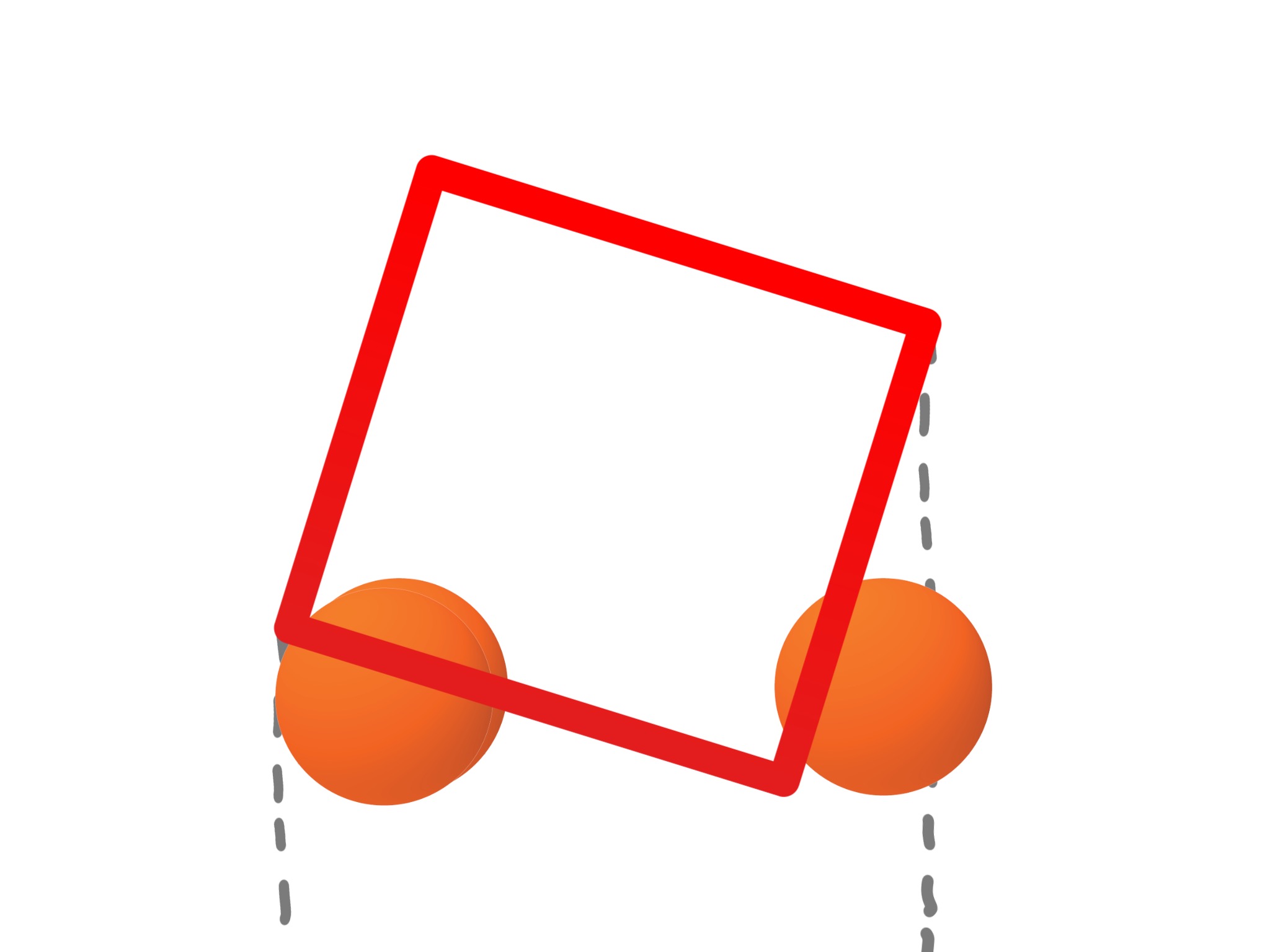

Here’s the relevant rule (emphasis mine):
Looking at the second image above, it seems pretty clear that the point of contact between the ball and the floor (roughly in the center of the ball as viewed from above) is within the vertical projection of the cube onto the floor, and thus criteria b is met.
So would this diagram be correct as far as the “vertical projection” that’s represented by dotted grey lines?
Yes, that looks approximately correct to me.
Yes, that’s what I thought.
