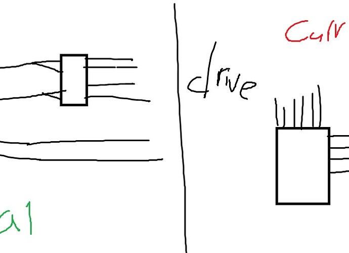

how are your y splitters setup? if you have 2 motors going into one port, then it will theoretically stall 2 times faster than a single motor. we had a similar problem and this was my solution. I apologize in advance for my horrible MS paint skills.
This is not true at all, a motor stalls from the PTC tripping, which comes from load and electrical energy not being able to convert to mechanical energy, rather converting to heat energy.
@legomstr1 my apologies, i meant to refer to the power cut that occurs if the motors trip the power surge protection. i found that many people fail to differentiate between the two. But yes, you are correct, the PTC is tripped when there is too much load.
Here is an example of what your wires should look like to avoid tripping the internal circuit breakers
That only gets you to 10 motors. 12 motors requires a Y cable some place.
