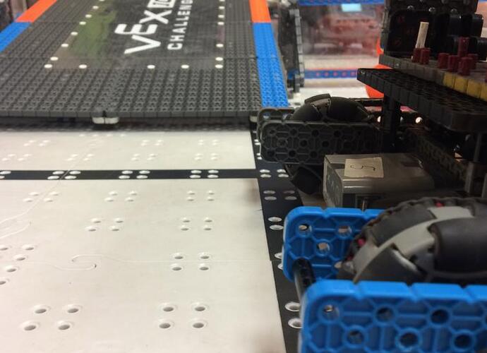

Is this inside the black line or up to the outside of the black line on the field?
Outside. The white square is 11x11", the black line adds 1" on each side.

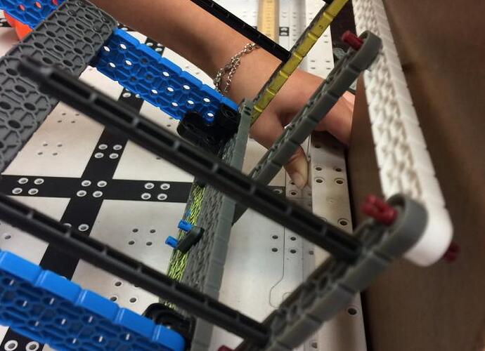

We have had several different experiences with inspection at competitions. Does the robot (picture posted here) pass inspection? The same robot passed one time and did not pass the next. Want to make sure it is legal before heading into the State Championship. Thank you!
Mrs.B: from the pictures, the robot looks legal. Measuring from one end to the other, it appears to be 20 inches, which is legal. Hopefully, the state tournament will have more experienced inspectors.

Can the robot be touching the wall at the start?
Nope.
