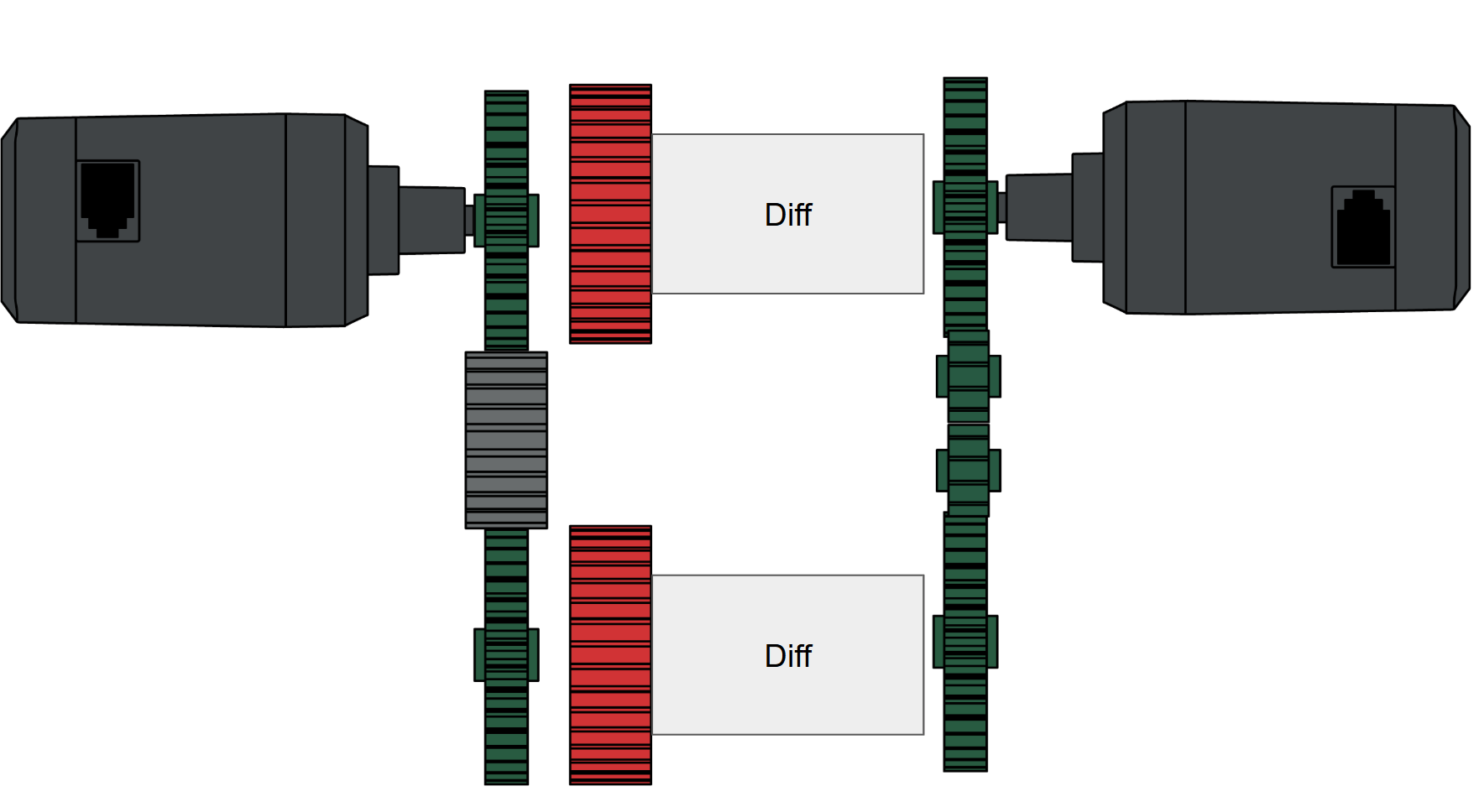

How I use diff:
red gear is the output

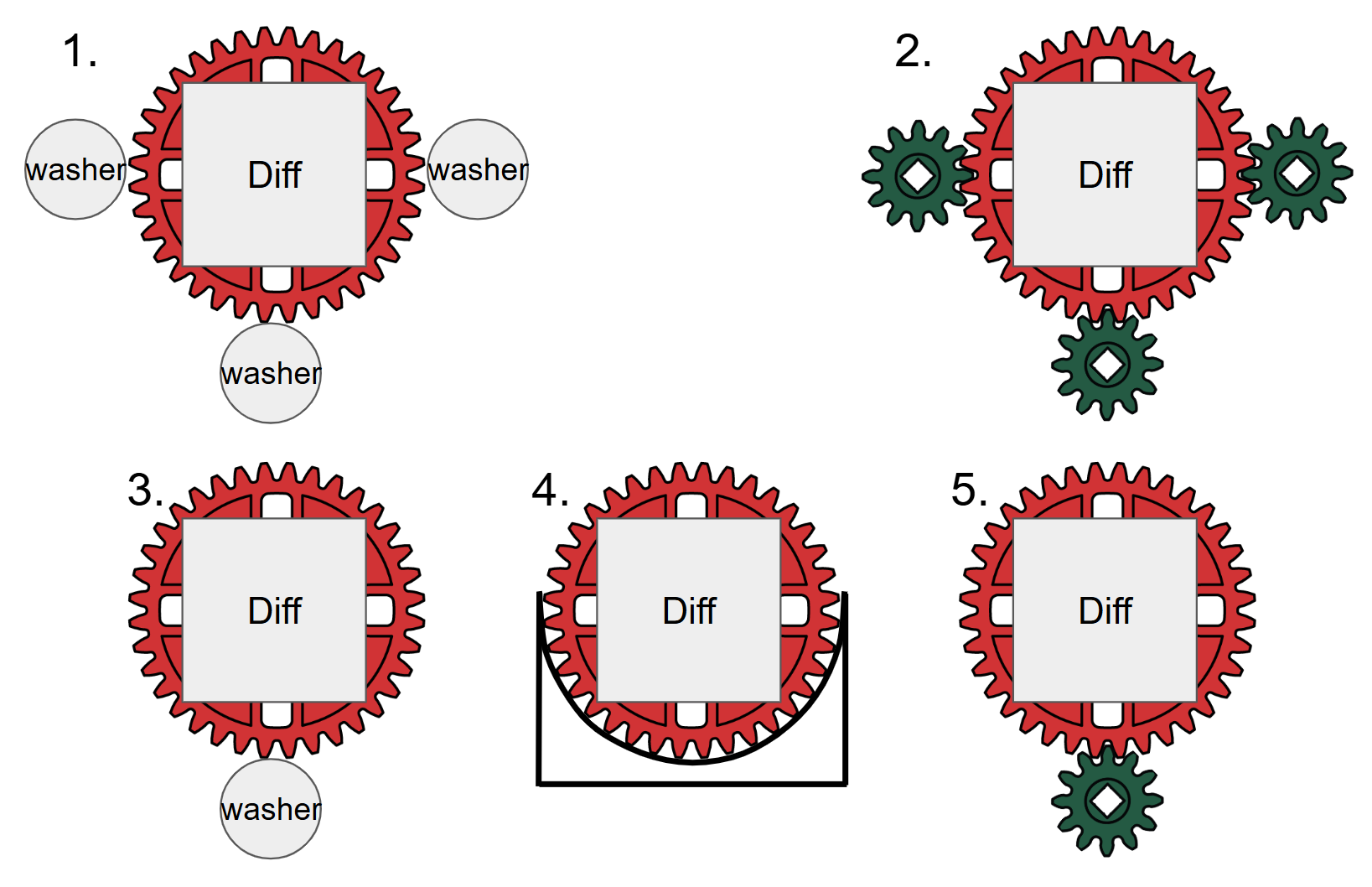

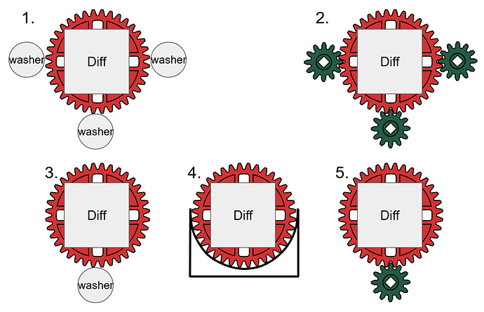

Maybe some kind of “thing” that supports the gears could reduce friction.
which one you prefer
  • #1
  • #2
  • #3
  • #4
  • #5
  • don’t add anything
0 voters

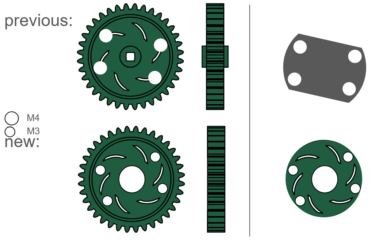

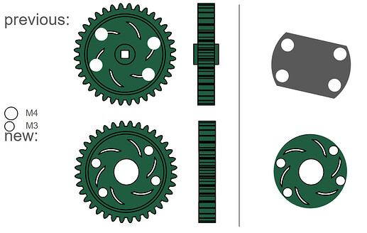

ST Differential V6 Concept:
(The previous version was v5)
The new version diff is expected to feature a smaller form factor (approximately 2mm), higher transmission efficiency & structural strength, and will not using additional plastic plates.
