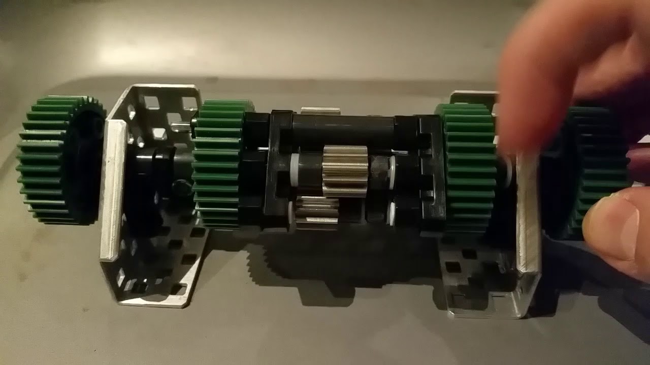

Straight teeth differential
Although Vex has its own differential, the bevel gears always wear out when I use it. So I made a straight-tooth differential myself.
Is there any way to make the differential smaller and lighter?

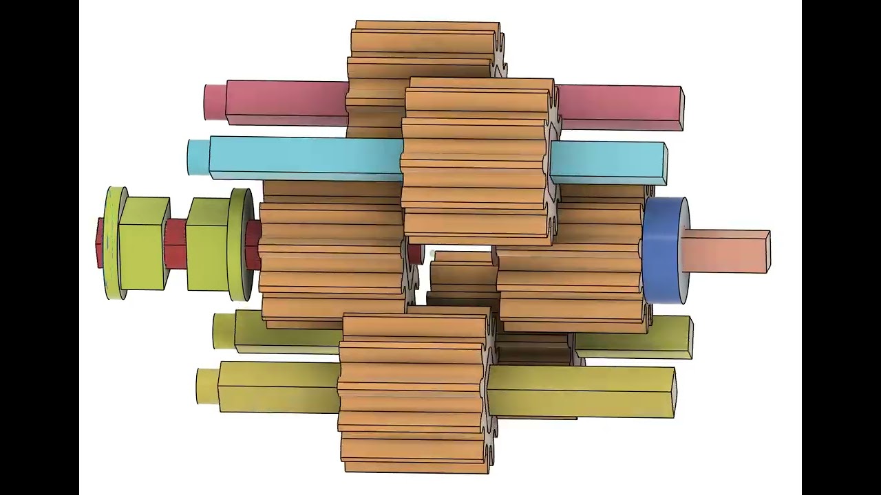

The easiest way to understand how a differential works is to hold the carrier (the piece that holds all the gears and spins around) still and look only at the two output shafts.
A ā€œstandardā€ bevel-gear differential relies on the fact that two bevel gears on opposite sides of a single bevel gear can only spin in opposite directions.
A straight-gear differential relies on a rather clever trick: each of the ā€œcenterā€ straight gears mesh with the other ā€œcenterā€ gear and ONLY ONE output shaft.
If you hold the carrier still and turn the ā€œtopā€ shaft clockwise (looking down from the top), the following will happen:
  1. The top shaft will turn the ā€œoutputā€ gear attached to it clockwise
  2. The top ā€œoutputā€ gear will turn the left ā€œcenterā€ gear anti-clockwise, since it meshes with one end of the top ā€œoutputā€ gear
  3. The left ā€œcenterā€ gear will turn the right ā€œcenterā€ gear clockwise, since it meshes with the other end
  4. The right ā€œcenterā€ gear will turn the bottom ā€œoutputā€ gear anti-clockwise, since it meshes with the other end.
If there was a single gear connecting the output shafts, they rotate in the same direction if the carrier is held still (exactly wrong for a differential).
The fact that there are 2 meshing gears, each connected to only one of the output shafts forces the shafts to rotate only in the opposite direction if the carrier is held still, serving as a differential.

After reading your post and doing a bit of digging online, I realized that I was for some reason operating under the misconception that there wouldn’t be planetary motion of the whole mechanism in this design. This video helped me realize this visually (see the end - where it’s spun while in a carrier). I now understand how the system works (great work @Lao6), so if anyone is still confused, I recommend giving the aforementioned video a watch-through, especially if you need to see it in motion to understand it.

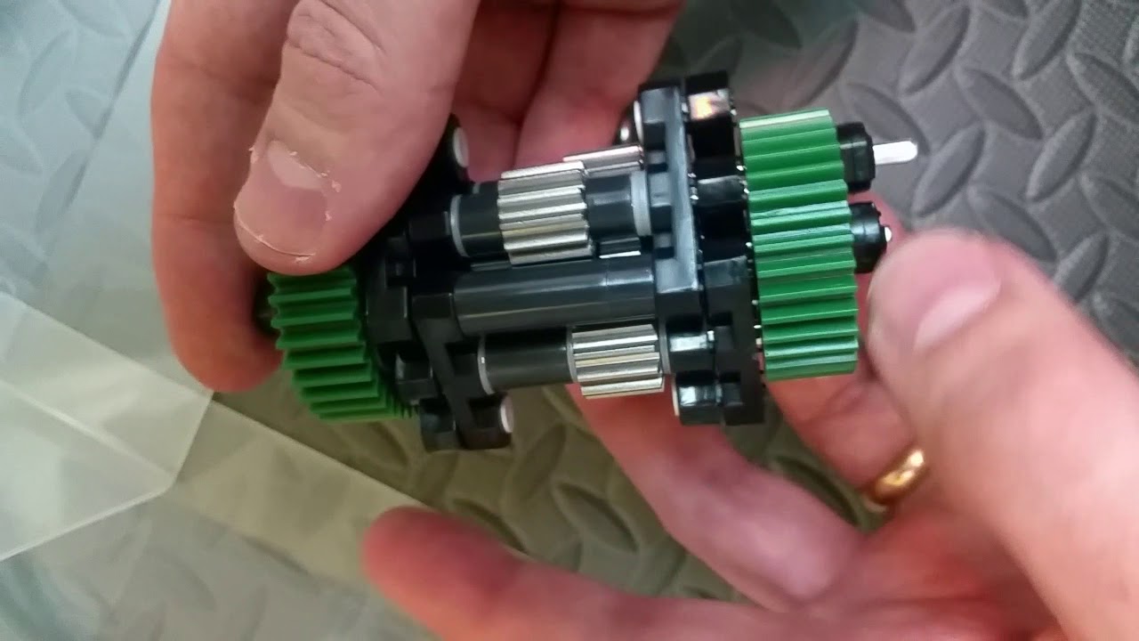

I freehanded these a few years ago, so there’s no CAD:
IIRC I was intending my next step to be to add strength in torsion between the framing gears to stop the axles gripping in the bearings. It was sticky despite all the teflon washers.
It didn’t see action on a robot - I was just playing with ideas to work into mentoring. You’ve flagged some of the basics to some extent, and there’s more or different design work to do before my version is any practical use, I think.

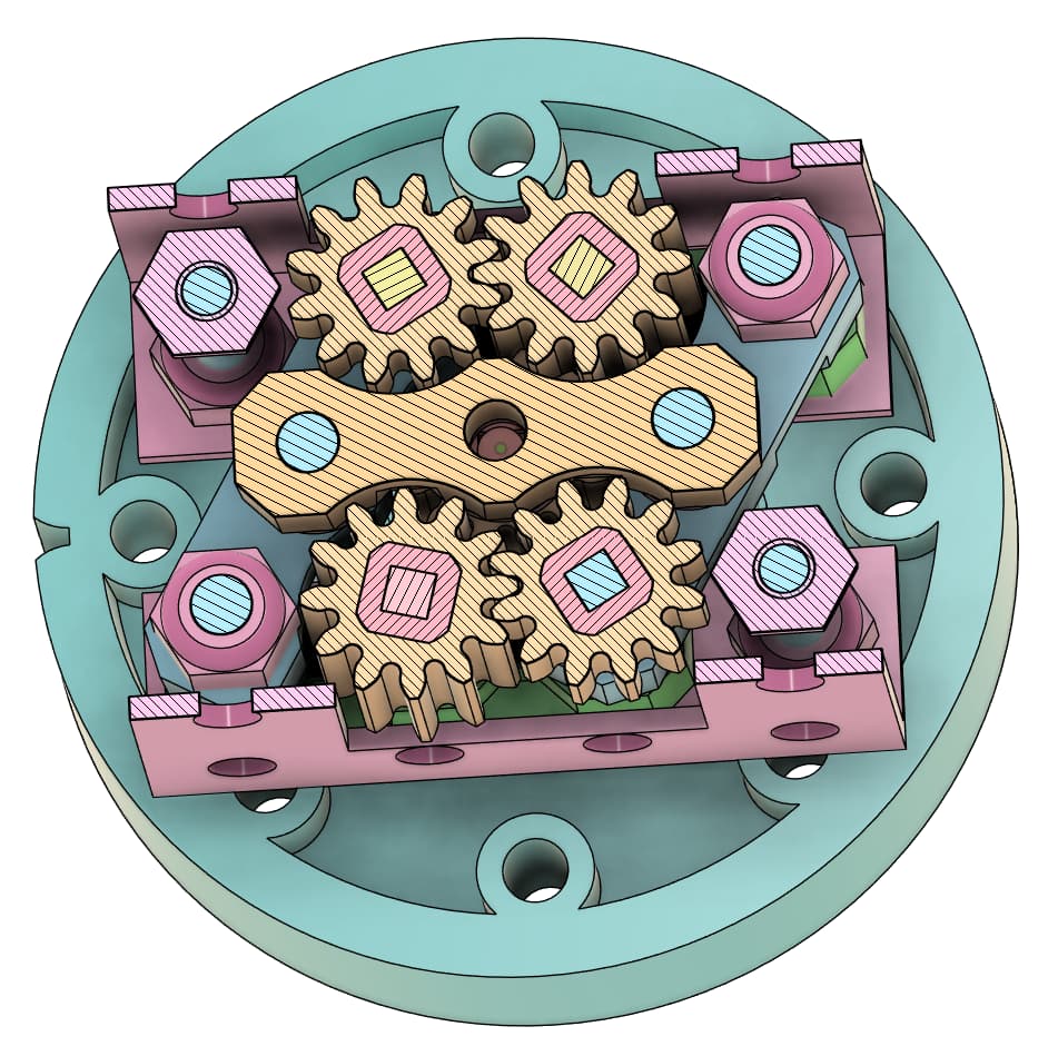

Turns out I CADded a diff with a frame, but this hasn’t been built never mind tested. This reminds me that the smaller one has dremelled bearing flats like you can see here.

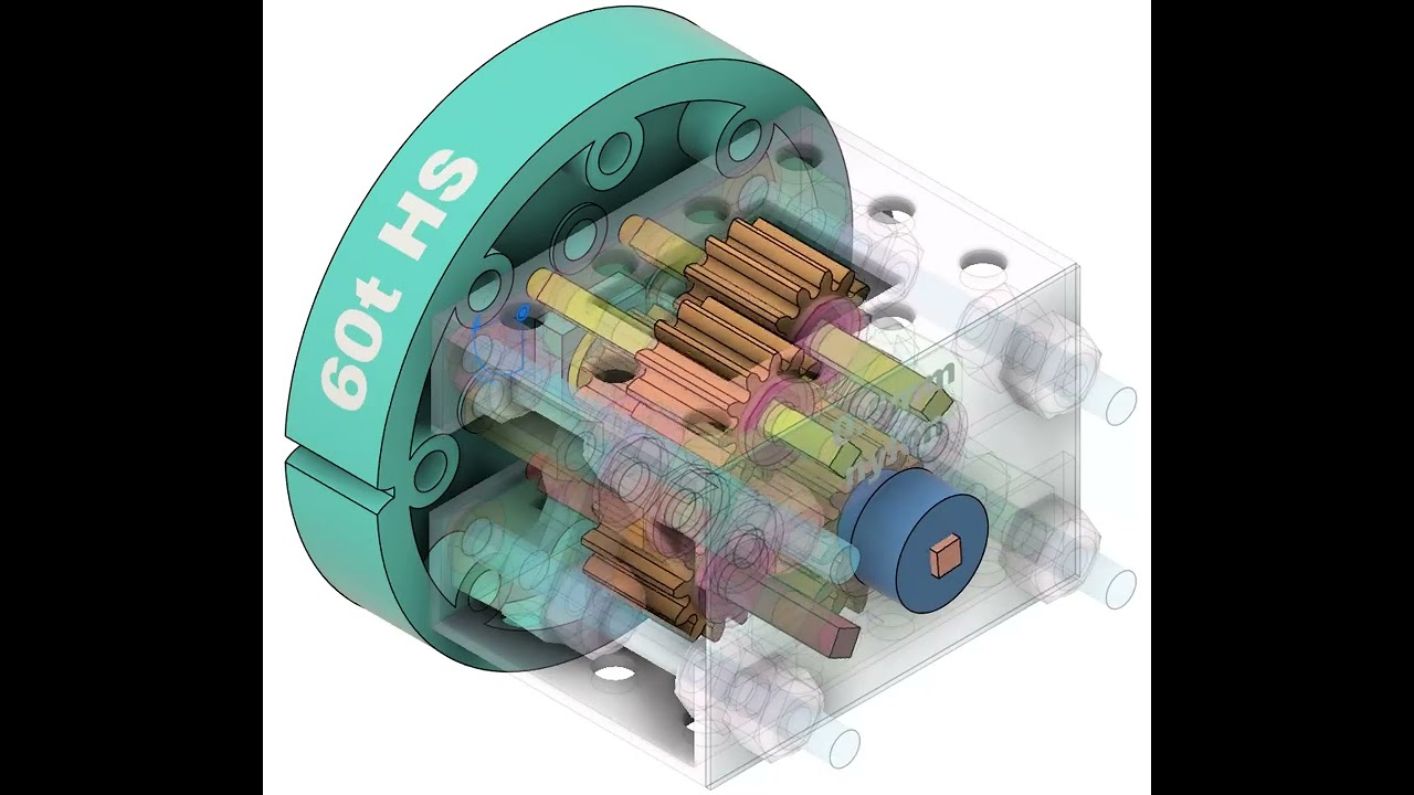

Here’s a more exposed view of the spur gear motions in my CAD. I’ve included a clue pointing to a potential alternative scheme for mounting the pinions.
My inputs aren’t answers to the problem - they’re just illustration of stuff that can happen, and you need to find what works for you.

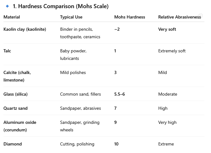

Be aware that pencil lead contains abrasive clay that will help rotating elements grind through their mountings. As for graphite, consider that conductive particulate matter is bad news for connectors and electronics.

Couple of comments, to dive deeper into this.
First, I had forgotten that pencil lead does contain a clay binder.
Second, I’m not an abrasive expert, but from using pencil lead in a bot that sustained a lot of use and heavy loads… there was no noticeable wear/polishing on the aluminum (was used on a sliding mechanism), so by gut said that it’s not a problem… at least under limited use that a robot will see. I probably wouldn’t use it in industry for a long time.
Asking chat gpt… and FWIW, here’s what it said.
Powdered graphite is presumably ā€˜pure’ but a heck of lot harder/messier to work with.
As far as conductivity goes… this would actually be a good thing. Let me dive deeper. I’ve seen some bots have problems with motors on arms/lifts frying. I bought a static electricity meter and learned that bots can generate a LOT of static (I posted on this here).
However, if a team is using plastic/nylon bearings, parts of the bot can be electrically isolate, build up a differential charge, and eventually get enough static charge to fry components. If graphite (or a grounding connection) bridged this gap… it would let the charge bleed off and avoid killing parts. We performed tests on this.
That said… I wouldn’t want graphite in my brain’s connectors.
I misremembered the nature of the clay. Thank you for that correction.
