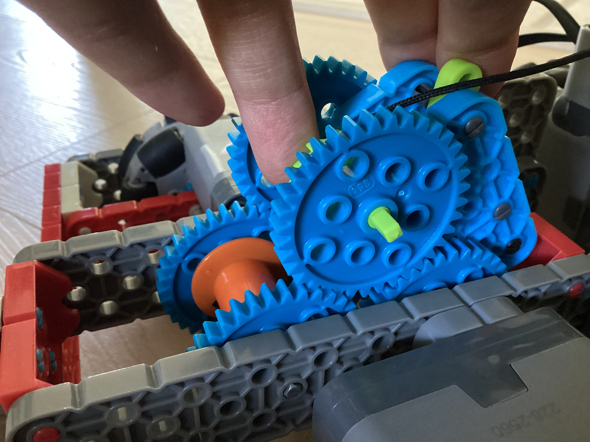

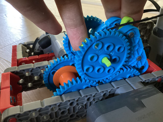

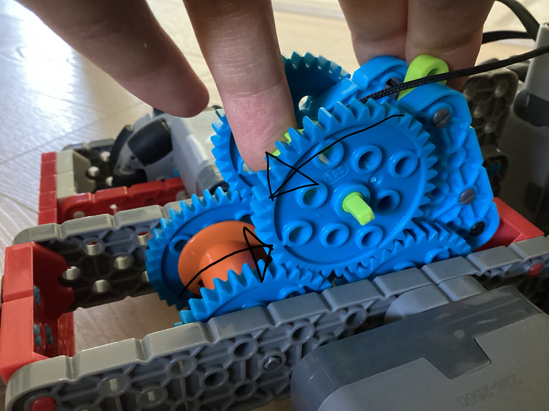

When I turn the motor on my gear box, my top gear (as shown in the photos) catches with the bottom gear because they are moving different ways. Has anyone run into this problem? Did I build it incorrectly?

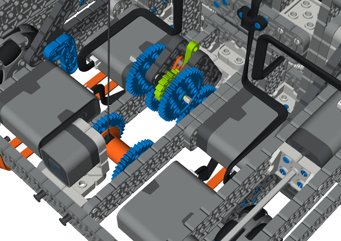

Well, comparing to the 3D build instructions I would say yes.
Yeah the winch gear needs to be farther apart. the gears are just pushing against eachother now
