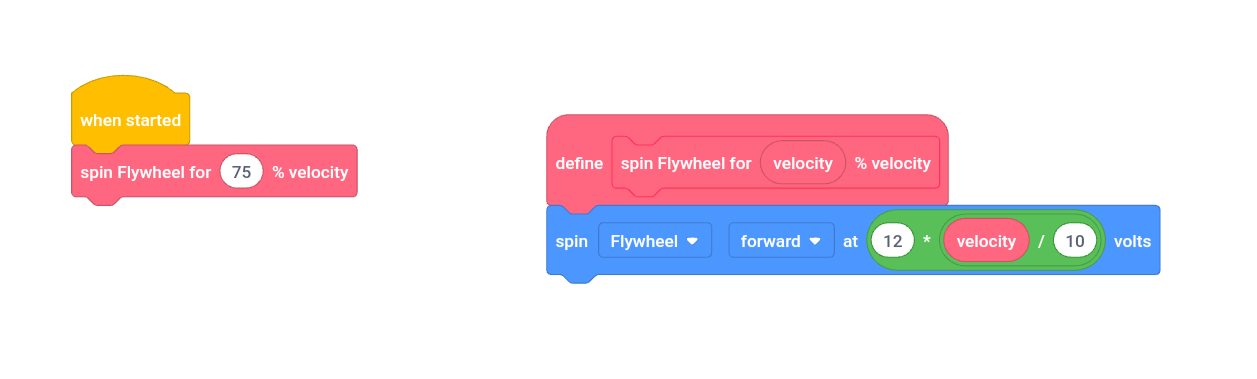

In my experience, using voltage for anything less than 100% velocity on a flywheel motor is the way to go. See Voltage vs Velocity control to see why I think this. If your code works good, however, no need to change it, but keep this in mind as a backup if you ever need it.
To use voltage instead, you could try making a function with the velocity input and have the function multiply 12 by the velocity divided by 10 and spin the motor at the outputted integer. Here’s that in V5 Blocks:
I’ve actually tried voltage control, and technically that’s what I’m using for the TBH loop (It targets a specific velocity, but I have full voltage control). The problem with voltage control is that it is very slow getting up to that velocity, I can never hit a very specific rpm, which makes programming more difficult, and it recovers slowly after a disk fires. That’s why I’m trying to get the TBH loop to work. I’ve actually got really got the loop working and it has a more stable rpm than pure voltage control, it just never hits the target (E.G. Target is 2400 and it will settle at 2100). That along with the slight issues with the motor flipping back and forth really fast which potentially heats it up faster.
