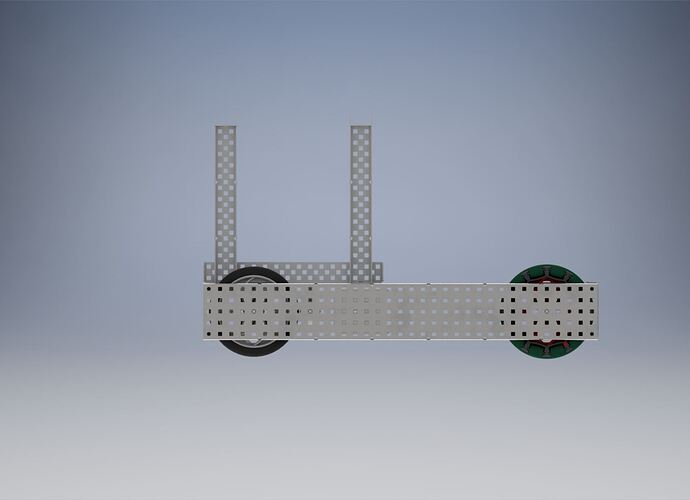

Hello everyone!
This robot is a culmination of 2 years of FRC and VEX experience, and is a collaboration with myself, and a Sophomore programmer. Additionally, we followed the idea of thinking outside of what our team normally does, which involves not building defense robots and building a robot which does not have to rely on alliance partners.

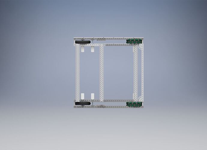

The whole plan is that in Auto, we grab the two closest opposing mobile goals, then try to grab a third, then park in front of the human player loading station, with 3 out of the 4 mobile goals inside the robot and let our partner score our mobile goals.
Will it be Worlds viable? Most likely not, as we only go to local CT events, as we focus on FRC more than vex.
Does it completely rely on our alliance partners to score points for us? Yes.

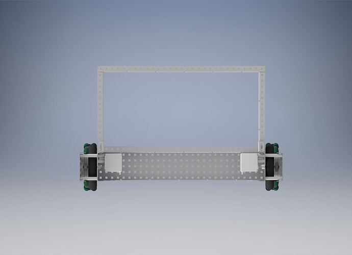

There are some things missing, such as two extra drive motors for the front, two side walls that extend out forward that will help capture a third mobile goal, a linear door on the front of the robot to contain the 2 mobile goals inside of it, and a brake on the robot to prevent it from being moved at the back. This is because Inventor does not like linear slides and constraining them.

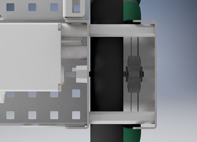

Also, I expect the team to add more structure to the robot for things like the electrical and the linear components. And yes, there are some points where some things need to be cut, such as the metal that the Omni’s rub against and the sprocket sides.
All motors are High Torque motors.

Hi! Love the CAD it looks great and this is the first proper defensive robot I’ve seen so it’s very interesting.
Just a couple of questions; have you made this robot in real life yet?
I noticed that the shaft goes through the middle row of holes on the 5 by c-channel. We made something similar (on Inventor) but having measured it we were worried that the c-channel would stop us from getting over the starting bar. So we decided to move the shaft with the wheel attached to the bottom of the c-channel. Although this isn’t the main objective of this robot if you have made it - has it been able to get over the starting bar? Thanks in advance,

No, it will be made when the high school starts up again.
While it is not designed for going over the starting bar, I think it might have the ability to do so. It will have 8 torque motors with a full steel robot, so it quite possibly may, but probably not, as there will be the linear lexan side walls which will most likely prohibit it from crossing the starting bar.
