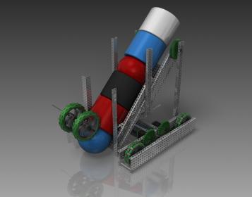

[ATTACH]4246[/ATTACH]

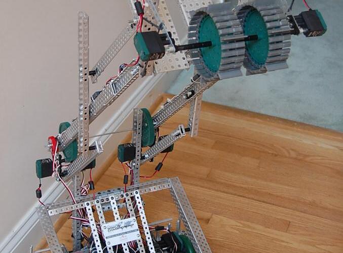

Starting off with our initial design concept, which was very rough, but seemed promising.

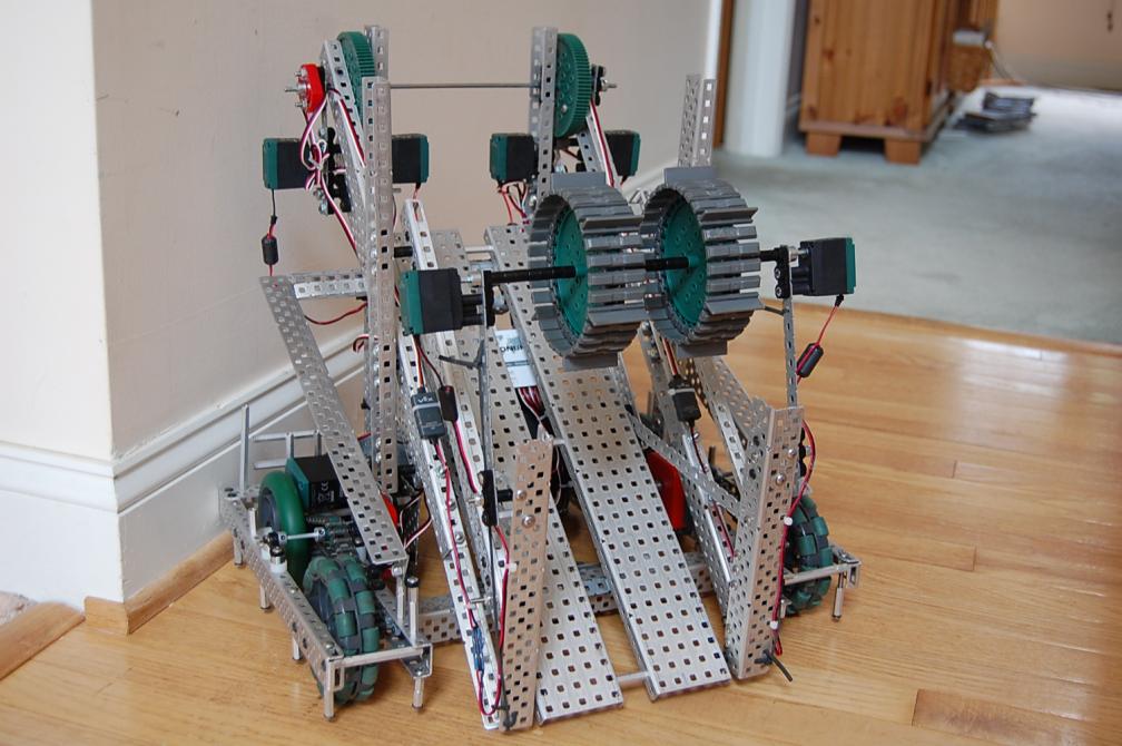

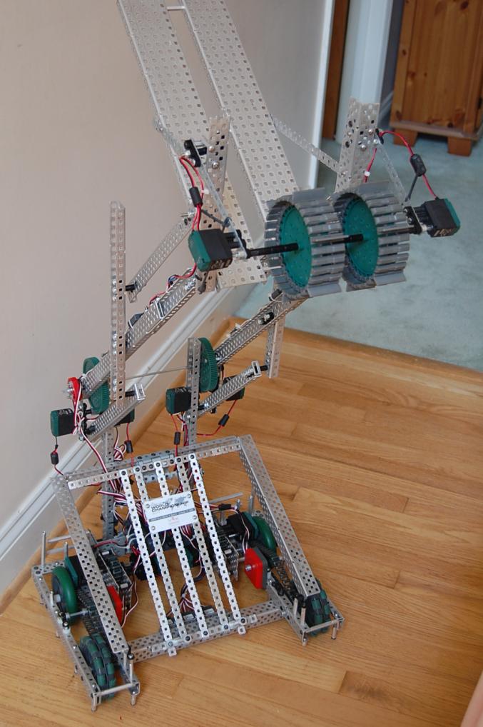

[ATTACH]4249[/ATTACH]
The basic idea was to have an “AURA-style” (seen on their College Round Up robot featured in this thread) 7-bar linkage to raise an angled platform with pivoting wheels/rollers on the front, which would spin to pick up the objects, loading them up the hopper.

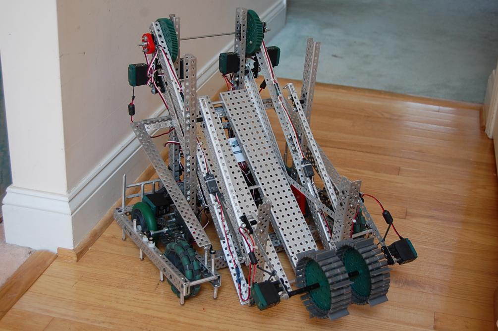

[/ATTACH]
We also had an idea for a drivetrain, and designed half of it in CAD.
[/ATTACH]
Here’s a better view of the chain run, which was taken by removing the back panel. The gear ratio is a 1:2 (geared up for speed), powered by four 2-Wire 393 Motors.

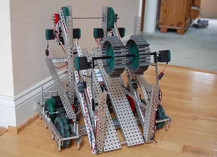

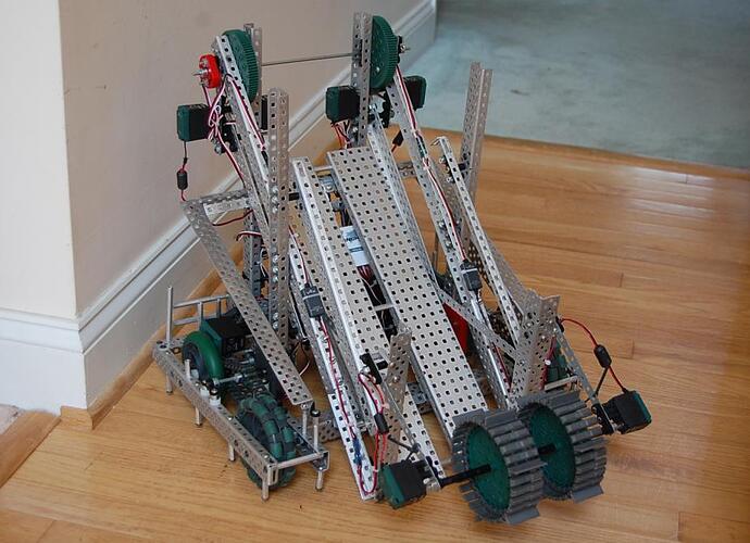

[/ATTACH]
Finally, the pretty picture of the final drivetrain assembly. The two batteries are placed in the very center, and low to the ground, as you can see.
