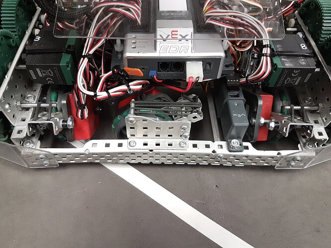

Will this work with V5? Because your tracking mechanism was using V4:
Just a little something, people usually don’t like to revive old threads.
Also, you would have to convert the code to c/c++ b/c the 5225a code (I’m pretty sure) was written in robotc.
Correct, the algorithm described in the position tracking document was used in that code (the actual code for the tracking algorithm is in src/auto.c if you’re interested). @64540A is correct that it is written in RobotC, and as we explicitly said, we’re not expecting anyone to be able to copy/paste the code and use it. Instead, we released the code so that anyone who’s interested can use it as reference and see how the features we made and used in competition were actually implemented.
