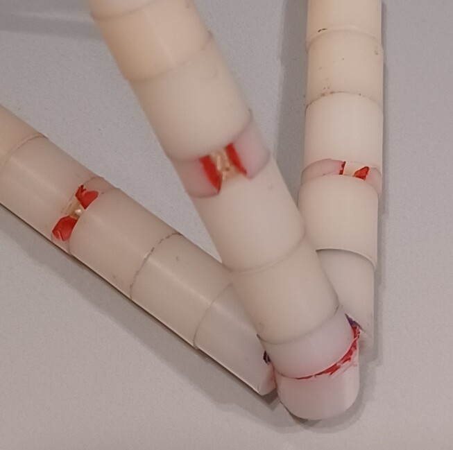

The trick to building this in real life is the custom ground corner and “pacman” pieces:
spacers1
After you get all the right angles on the corners and pretighten the rope, assorted “pacman” spacers will let you to taut it for extra rigidity and balance the length of the edges:

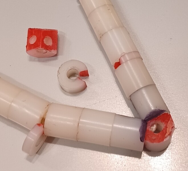

Spacers with a cutout on them so they can slip in, like the new clip on spacers in EXP
With the “requirement” to custom machine a few spacers to pull off this design, I was wondering how polycarbonate might be able to be used to push this innovating solution to the next level.

Just like @OrangeMan said, I’ll use “pacman” spacers.
My “custom machining” was done with utility knife and hammer and then a bit of drilling and grinding with a dremel.
