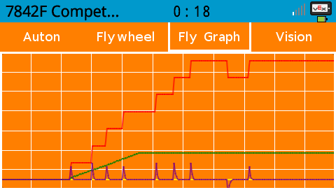

Will there be debugger support in any of the platforms going forward? Although I was not a huge fan of RobotC, the debugger and data collection capabilities are sorely missed.
There is a datalogging project being developed for pros called JINX.
However, progress is slow, and it might take some time to be released.
Personally, I have developed some solutions for my robot.
I have made LVGL graphs, dials, and pages, I have used terminal output, I have made a utility that can store values in a CSV onto the SD Card for graphing on the computer.
RobotC was extremely nice, and it is unlikely there will be something equivalent (you won’t be able to just manipulate variables without setting up a process first), but it is possible to get by with tools available.
Edit: I can probably provide one of these utilities if it would be useful =)
