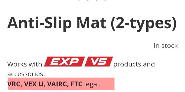

Can you use anti slip mat material on the claw of a robot and it not be illegal or disqualified for the over under vex competition? I am worried that it is not legal material, though I saw videos of robots using it on the internet. Thanks for any guidance!
It is legal
If it is not explicitly prohibited in the manual, it is legal
What rule in the game manual makes you think that putting anti-slip mat on your claw would be illegal?
When you go to the Vex robotics web page for parts, you will see on each product listing whether the part is legal for competition. For example, anti slip mat is found here:

Just make sure your mat is the one from VEX, or is able to be cut from a 12x15 sheet. I ran into this problem designing endgame blocking for Spin Up, as I believe its legality is ambiguous or it is technically illegal to use non-VEX mats. However, if it doesn’t exceed the original dimensions and does not grant any competitive advantages, I’m sure you will be fine.
Something to be aware of- if you are going to purchase non-slip mat from a source other than VEX, make sure that you purchase a product that is identical to what VEX sells. Stores like Walmart sell non-slip mat in many colors, but VEX only sells black. Years ago we used to use any color, but last year there was a Q&A that stated that only black is legal. I don’t think it has been asked this year, but to be on the safe side it is probably best to stick with black.
