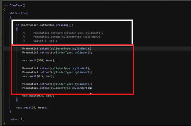

There's something wrong with my code I can't find a way to fix
I’m writing my code for my robot and I’m stuck on this one problem: When I use this task, and i disable the first part(white box) of it, nothing happens. It doesn’t even do the second (red box) part. :sob: Even if I don’t disable it, it only does the white part.

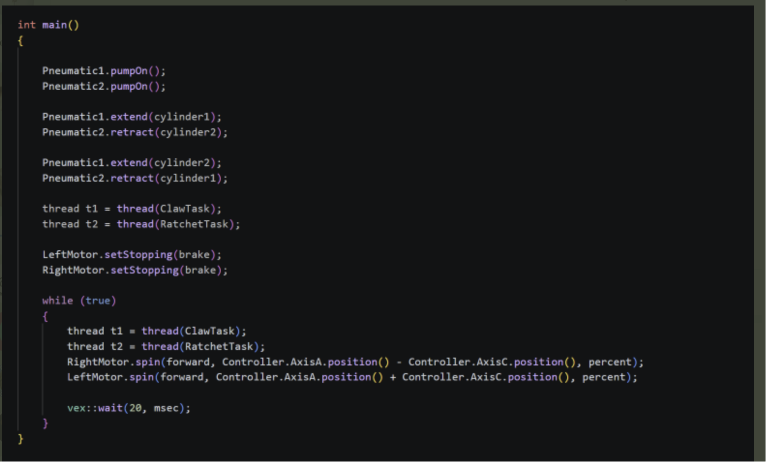

Don’t start the ClawTask and RatchetTask inside the while loop in main, that will cause them to keep restarting and never really run.
Thank you , you helped me solve my problem!
