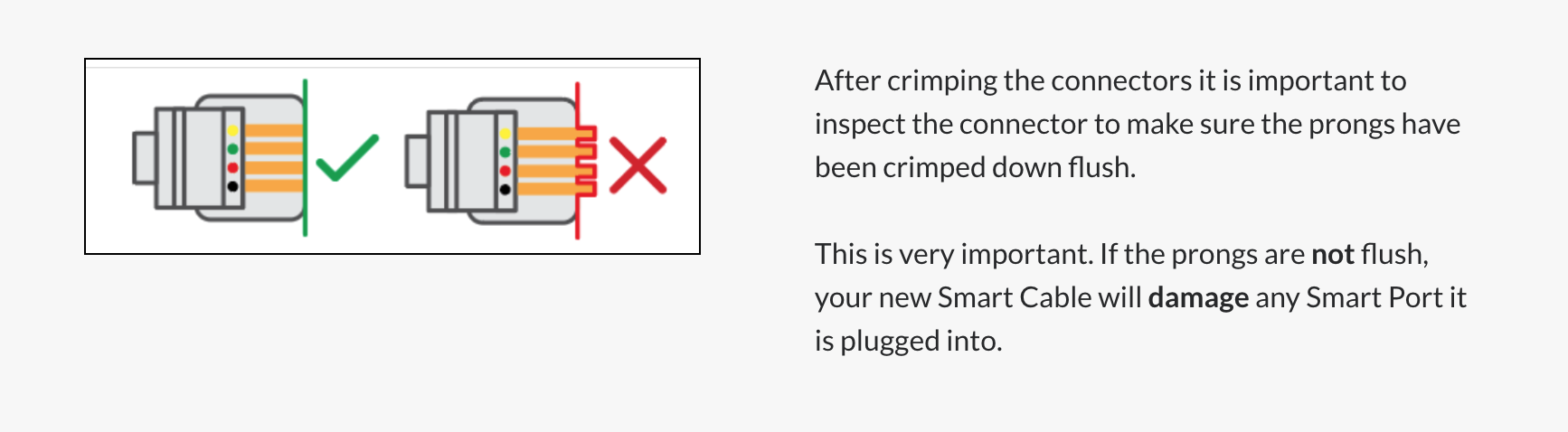

I have seen this before and the going theory is that a lot of this damage happens when you build custom cables and don’t fully crimp the connector. (again just a theory it could be caused by other things as well). I have seen ports with the prongs bent completely flat and bending them back will get the port working again. Making sure your cables are all crimped well will keep those ports from deforming in the future.
This issue is briefly mentioned in this VEX Library article (https://kb.vex.com/hc/en-us/articles/360036143012-Using-the-V5-Crimping-Tool-to-Make-Custom-Length-V5-Smart-Cables-)
@evasnphysics is absolutely correct in that this is a delicate procedure. You can easily permanently damage the port if you are not careful. We will get some best practice documentation put together and share that when it’s ready.

Brain had 10 fully “dead” ports and 3 with loose connections. (on a competition robot with 8 motors and a radio)
Now all ports connect, but 2 do have communication issues (flash red)
With a casual inspection, all cables seemed to be fully crimped. With a little magnification, two ends might not have been completely crimped. When recrimping, you could feel some resistance at the end to the crimper squeeze (they were not 100% crimped).
We can’t say that the cable end was causing the problem, but it would explain the large number of bad ports as they switched to new ports as one would be damaged during the season.
