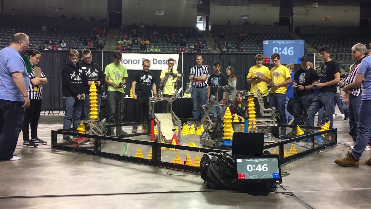

I wasn’t ignoring this question, just wanted some time to do some tests and give a considered answer. I cannot give an answer regarding match replays, that decision needs to be made by the division manager in consultation with the engineering staff on hand.
Despite the further tests I have conducted, I do not have any new insight as to what may have happened in the various match videos that have been posted during the last few days. All I can really do is repeat the information we currently have that @Dave Flowerday has also been promoting.
  1. If either primary controller on an alliance has an issue with the competition connector that causes the enable signal to short to ground, both teams on that alliance will be disabled until that condition is cleared. The driver interface will show a solid orange disabled led if this happens and the primary joystick will also show an orange game led. This should be visible to the field techs.
  2. If a cable is disconnected from the driver interface this will not disable the alliance.
  3. If VEXnet disconnects, this should be visible on the leds of both joystick and robot. I still find it hard to believe we have simultaneous VEXnet disconnects for only one alliance where both robots also appear to reconnect at the same time.
  4. Disconnecting USB from the match controller will remove power and tend to leave the robots in an enabled state. If a powered USB hub has been used and the connection to the PC lost, power will be maintained and, depending on the host computer, indeterminate states can be reached but in all cases of USB being lost tournament manager is alerted and often has to restarted. From what I observe I think it’s unlikely USB issues are a factor.

I can confirm that it is not the case that robots are being disabled; based on my own observations both the field controller and my joystick both showed enabled during the first part of the disconnect (the joystick later went to the disconnected pattern). Furthermore in the video below a ref can be seen pointing at the driver interface and saying that it is enabled (also visible is the solid blue light on the vexnet key which AFAIK show that the controller is at least disconnected).
I can’t confirm for the robot, but I can confirm that for the joystick, after about 2-3 seconds, the lights did switch to the disconnected pattern (unfortunately I cant say which specific mode of disconnection it was in, as I don’t have the joystick light codes completely memorized). The light on the vexnet key also went solid blue as seen the videos.
I honestly don’t know what to say to convince you that these disconnects are real. I linked to 5 videos of simultaneous disconnects in this post: https://vexforum.com/index.php/conversation/post/265762
If that is insufficient evidence then I honestly don’t know what is. If you are saying that it is unlikely to be a simultaneous disconnect because the robots reconnect at the same time, have a look at the video from the US Open Finals 1 where 202 clearly reconnects faster than 8675. Regardless, wouldn’t it actually be likely that both robots connect at the same time since they are being influenced by the attractor vexnet key at each field* (will explain at bottom of post for those who don’t know) to join a specific channel and thus don’t have to spend as much time searching for one?

In this video, a field tech (woman with black clothes that comes from the background) walks over after hearing me say that I have a disconnect. however, by the time she gets to the field and has a chance to look at the lights the problem has been resolved.
In this video, the same thing happens.

Pretty much the only situation I can simulate and test for is a single match being run by the field control system. It’s obviously limited, I cannot simulate 500, or even 50, robots all running simultaneously. So with this rather simple setup I can test for unusual events, cables being removed, unusual host computer activity, things of that nature.
It’s not a question of convincing me, I’ve reviewed the videos and can see what has apparently happened. I’m just saying that what I’m witnessing doesn’t correlate with what I’ve experienced first hand in the past at regional events in socal and at worlds over the past 8 years.
