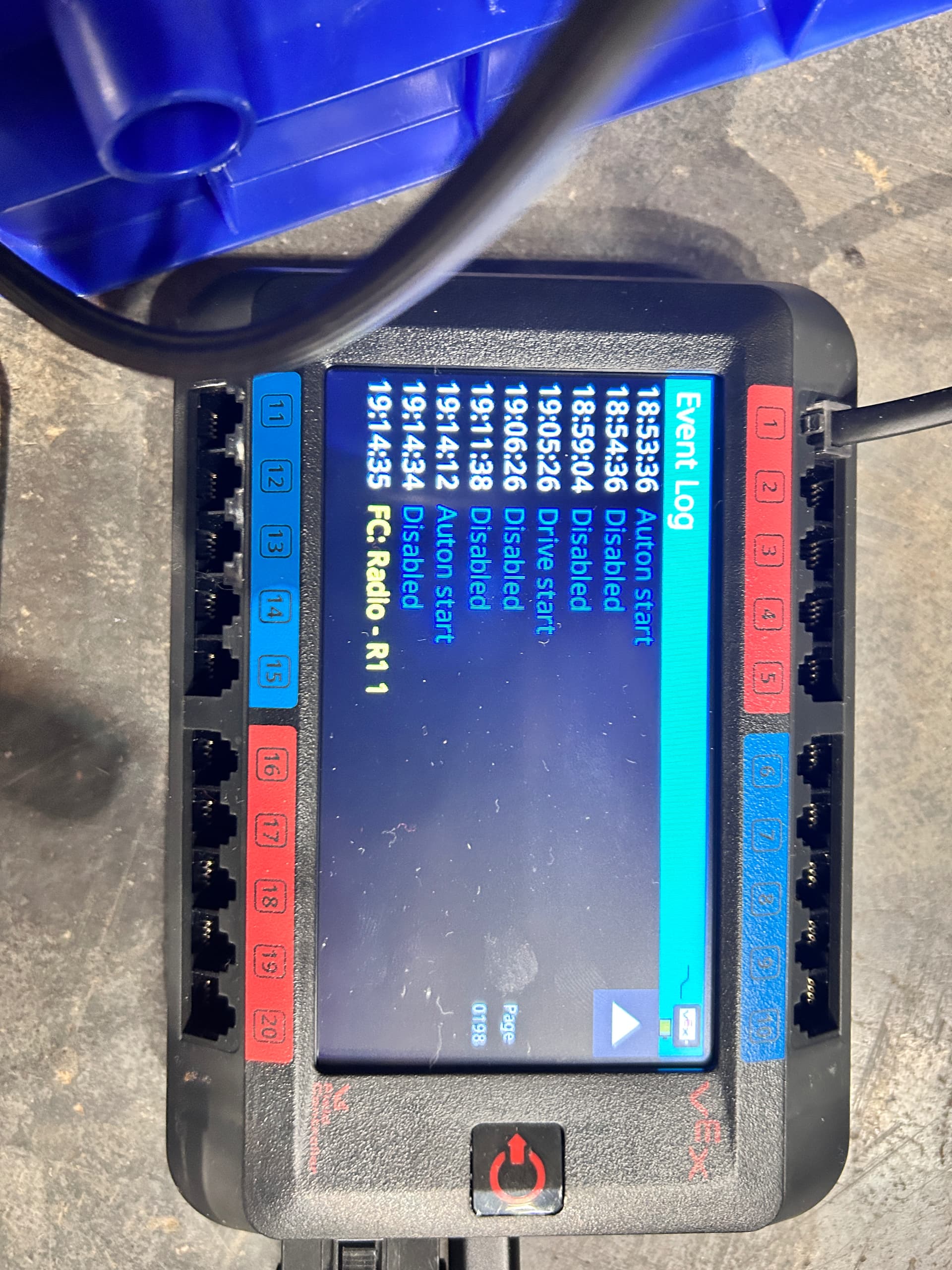

During auto skills, our bot would disconnect from the field, and field controller logs show this error (attached below). Is this our robots fault or is it the field controller’s fault. If any official vex staff or support could confirm this that would be greatly appreciated.
You had a disconnect between your robot and V5 controller, that is, a radio disconnect. Not a field control issue.

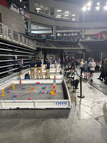

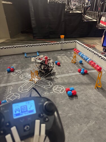

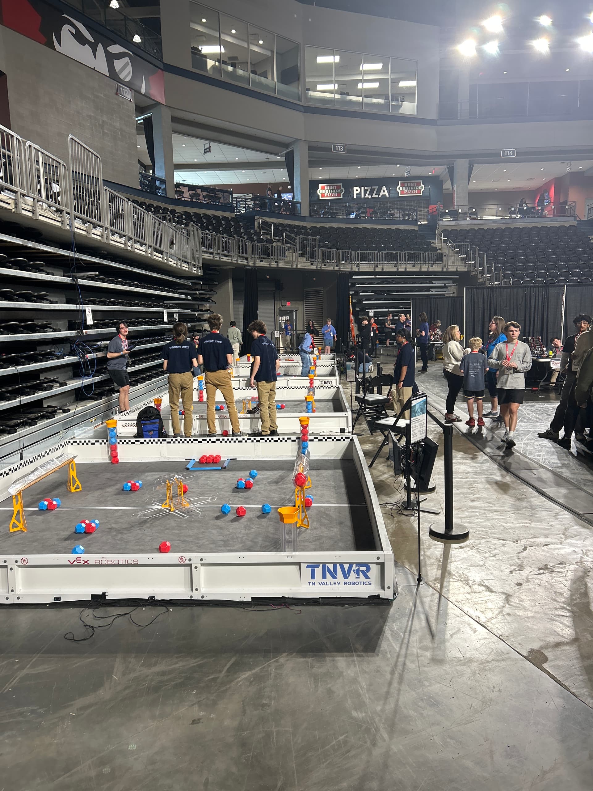

This happened to multiple teams on multiple different fields. Could it be due to density? I know vex uses Bluetooth. We are using vex net here. Attached is an image of skills field area. Additionally, another example of the error where the bot completely disconnects and gets sent back to the program picker.

I have no insight into the OPs specific event and how it may have been setup. Was wifi disabled in the arena, any microwave ovens present (known to cause issues) etc. OP should discuss any concerns with the event staff,
Thank you all for your help. We were not able to diagnose the issue but we believe it may have been due to the individual radios of the bots. Additionally, the specific field was set up in a corner surrounded by concrete walls as well. Our event staff was also unable to diagnose the issue and were unable to pinpoint the source of error without running skills on Bluetooth, which for some reason was unable to be enabled on the field controllers. Microwaves were present I believe but they were on higher floors of the arena. Thank yall for your help though!!
