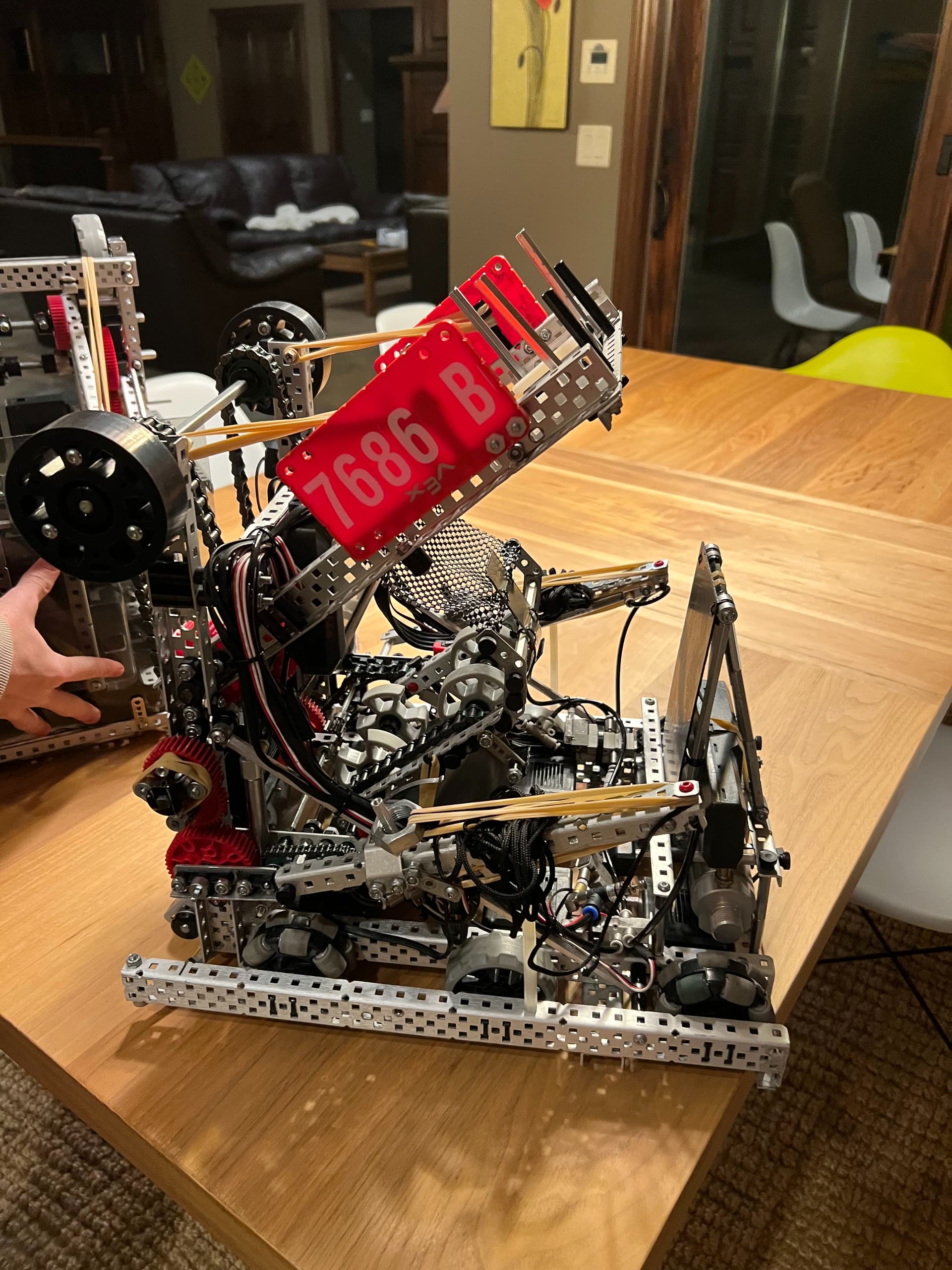

Here is our 3rd robot of the year. I think it’s final weight was around 12.5 or 13 pounds. Here are some of the weight saving methods employed:
  • Thumb Screws- the only legal nylon screw
  • Nylon nuts- you are still allowed to use nylon nuts
  • 1x1 L channels- Really useful for not overbuilding mechanisms
  • Aluminum Standoffs instead of screws and spacers- lighter, just make sure to use loctite.
  • Zip tie bearings on drive
  • Right length of screws everywhere
  • BUILDING SMALL- too often I see robots on the 18 by 18 limit. In most games, a smaller robot is better for maneuverability. This robot is 25 wide, which helps with low goal navigation
  • All Aluminum C channels and L channels- this one is pretty obvious
  • NOT OVERBUILT- If applicable, you could use lexan for mechanisms. You don’t need to cover your robot in useless material.
  • One tank- we use our 3 shot power system on this robot, but we only use 1 tank because we conserve our air in match.

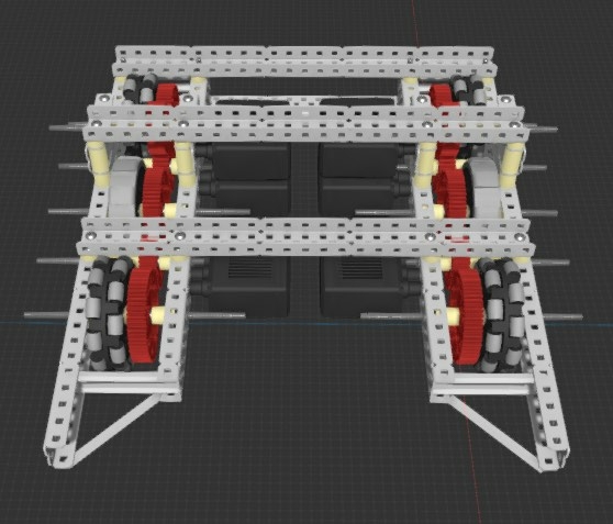

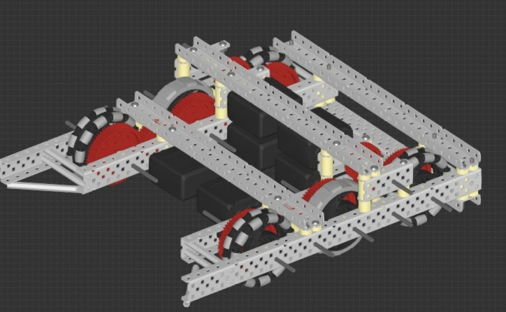

But I must differ from your statement, aluminum 3 wides are nearly double the weight of aluminum 2 wides. I would suggest building a drivetrain made out of two wide aluminum c channels.
This is a pretty light, very rigid drivetrain made from two wides.

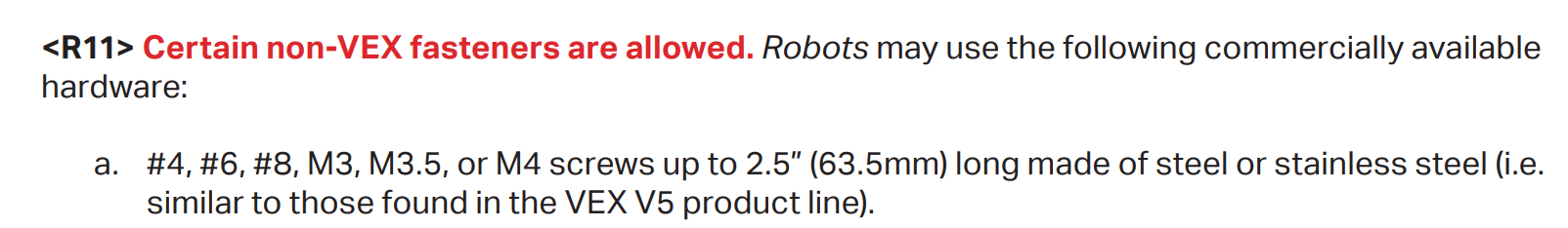

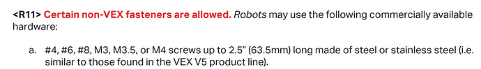

I might be wrong but isn’t this a R11 violation
No. According the Vex Product page their Nylon thumbscrews are legal, R11 only covers non-vex parts. This part is made my Vex and had the VRC legal tag. Screws - VEX Robotics
