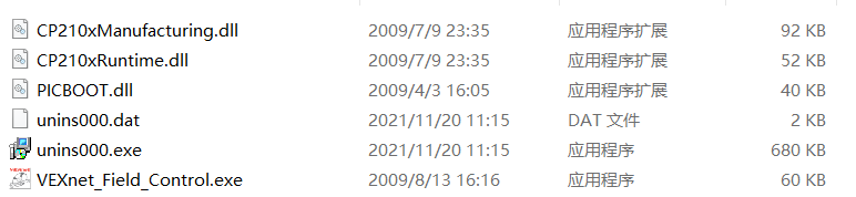

It seems that this .exe can’t run normally:
As you can see, this .exe was created on 22 Sept. , but actually I have reinstalled the whole tournament manager just now. Does it have something to do with the problem?
I installed the former field controller before, but now it has been uninstalled:

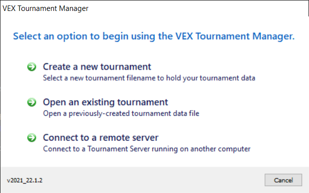

When you first launch TM do you see this screen below? The images you shared are for connecting to a remote server on a different machine.
You should be selecting the top option to create a new tournament or the second option to resume an event you have already created.
Of course I do select the top option. Then you should see a smaller screen that says"waiting for the tournament server to start", but I can’t go on correctly after seeing that small screen. Actually, the screen will appear for about 30 seconds, and then it will show me the screen I provided in the question(connecting to a remote server).
So I mean that the tournament server on my computer can’t work as expected, and it always fails to start according to the request of tournament manager.
