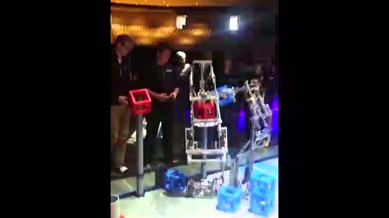

I have been looking for an example of a reverse stacker, but couldn’t seem to find anything. Could you explain how this is done or show a robot that does this?
Skyrise season robots from AURA or 185A are first examples that I could think of.
A lot of VRC teams either grabbed cubes individually (with some sort of hooks) or would only collect two cubes. 185A was a rare exception. On the other hand many VEXU teams could pick three cubes with their 24" robot.
As TT cubes are not hollow you will need some sort of external guides to collect several cubes and then either drop them down or carefully open those guides to let the cubes stay on top of the stack.

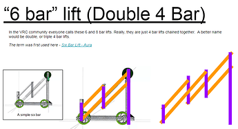

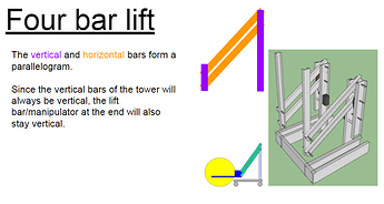

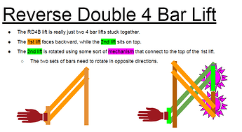

Hello, being only our second year and getting a late start this year, what is RD4Bs pleasae??
Basically two four bars stacked on top of each other facing opposite directions- hence the name reverse double four bar or RD4B for short. If you want to see what they look like, most of the high school world final robots were RD4Bs.
Four Bar Lift:
“6 Bar” Lift
Double-Reverse-4-Bar Lift
In motion:
