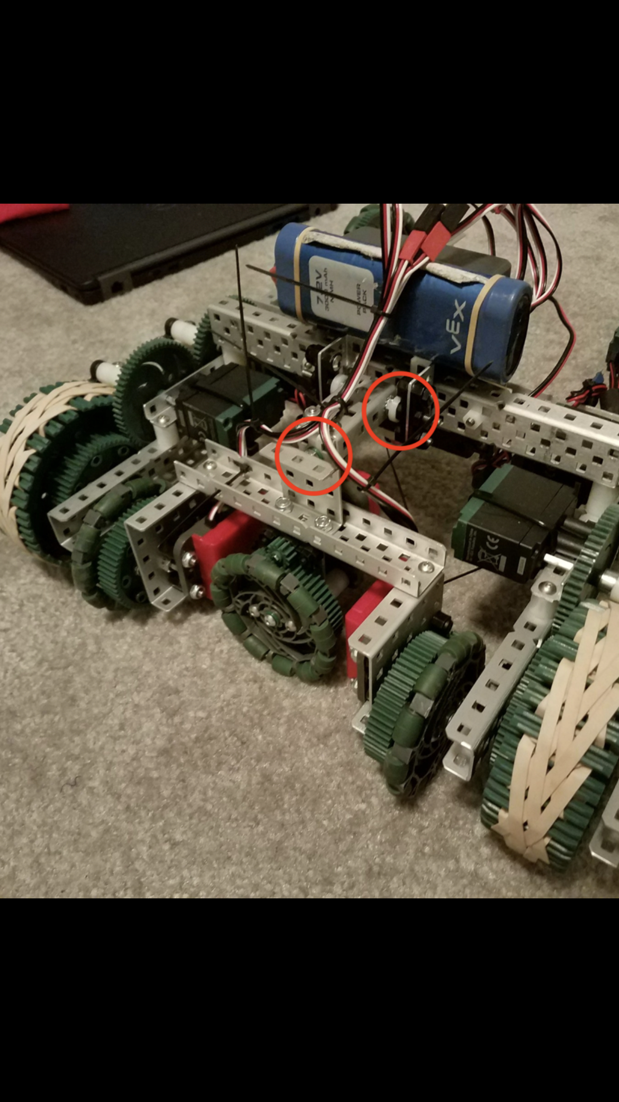

Oh and it has been done before –– took forever to find this image

Hey, were those thin roller wheels discontinued? Im a senior in highschool, and started when v5 came out. Ive only seen them on a couple bots.

Those are 3.25" Omni wheels cut in half. I would recommend you do the same on the 4" wheels so you not only get two tracking wheels from one full size wheel but you also cut the size of the wheel in half so you can fit a gear within the footprint of the full wheel.
