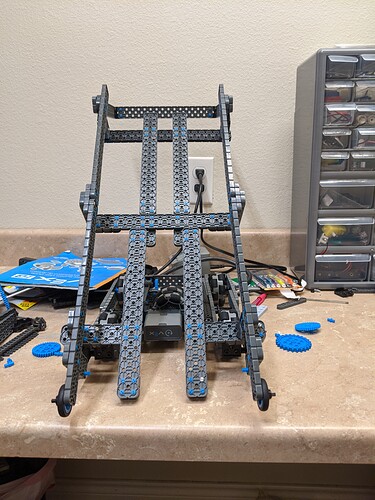

I know that their is already a topic for robot ideas but I feel that this needs its own topic. Right now I am working on a tray bot for rise above and am wondering if anybody thinks that this is a viable robot. The thing that is stumping me right now is the intake because you have to flip the riser onto the tray then you have to move the riser out of the way for a new riser to flip onto the tray. The robot will be like a TT simple tray with no moving arms. I do not have my tilter on yet but it will be like a TT tilter.
Dang. I would really like to see how that intake would work. Are the risers going to just fall out the back? Or is there going to be a tilter like TT robots?
I think there is gonna be a tilter
It is going to be a tilter
The part that is dangling off is the second stage that I’m building. The intake is going to be the hardest part of this robot because you have to tilt the riser into the tray and still move up the tray.

Honestly I think making it vertical would be better. I don’t think the risers are as unstable as the cubes from TT.
I have been thinking about that too because that would get rid of the hardest part that I have been building but now the problem would be getting rid of the stack.
Have the intakes contact the upper half of the risers, which will tip them backwards and into the tray

I was talking to somebody recently about this design. Yes, it certainly is possible but I don’t really think it would be able to stand up to the inevitable variables in a team match that might require you to stack a riser your teammate missed or something. Great potential but just not adaptable/flexible enough would be my take on it.
How does the robot look now?
I’ve tried this concept (mine flipped upright). Trust me, it’s not worth it. The intake doesn’t work, the chain will always sag under the riser’s weight. Plus, just picking up the risers almost never works either because the intake just isn’t strong enough. And if you’re looking to score more points I don’t think the tray bot will be fast enough to do that. There are already metas on YouTube that work better.

I also think that it would be a pretty effective design, but I have a few concerns.
  1. The height and length of the tray with three Risers in it could make the robot tip back (easily remedied with anti-tips) and even knock over other stacks three high.
  2. I think that it would take a while to tilt and drop the risers into the goal.
  3. Picking up stacked cubes from an angle in Tower Takeover was incredibly hard, and was one of the main engineering problems. So picking up risers like that instead of cubes would be super duper difficult.
  4. Flipouts are never not annoying to deal with. (but that doesn’t mean they’re not crazy cool!
