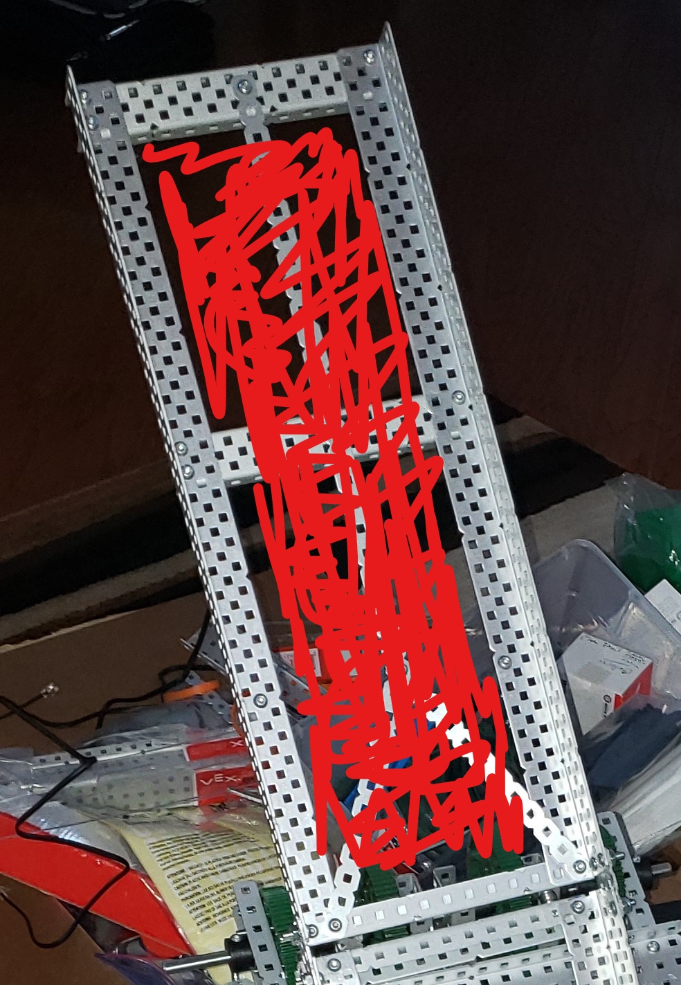

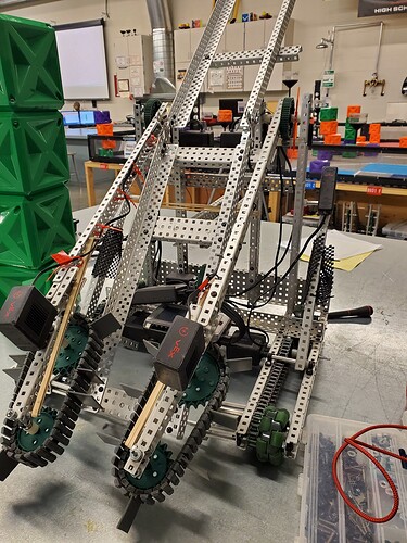

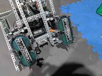

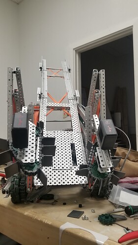

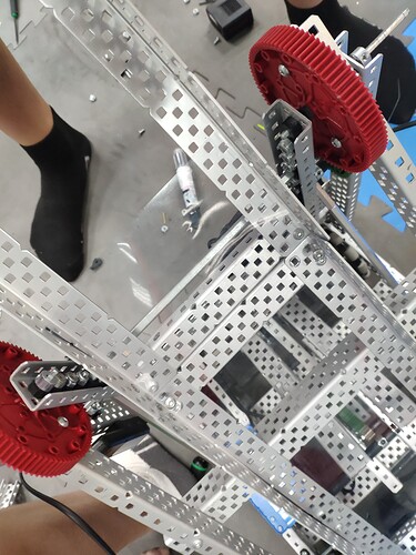

Some tray designs…
Full sized Images and Attributions
I want to hear your opinion and testing done with this so that we all can hopefully learn something.

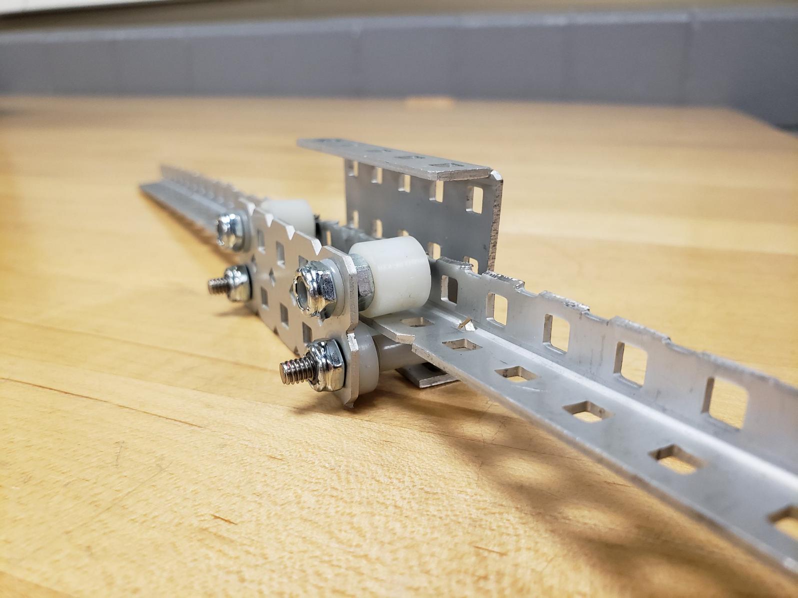

I think the C-Channel tray stages are better for doing a telescopic tray, but the angled bar trays are much better generally for everything else. It’s easier to mount lexan or zip-ties to them and the base of the bars supports the lexan and zip-ties well to allow for the cubes to go over.
Although, I don’t even know if you can do a telescopic tray with angle bars, unless you heavily modify it?

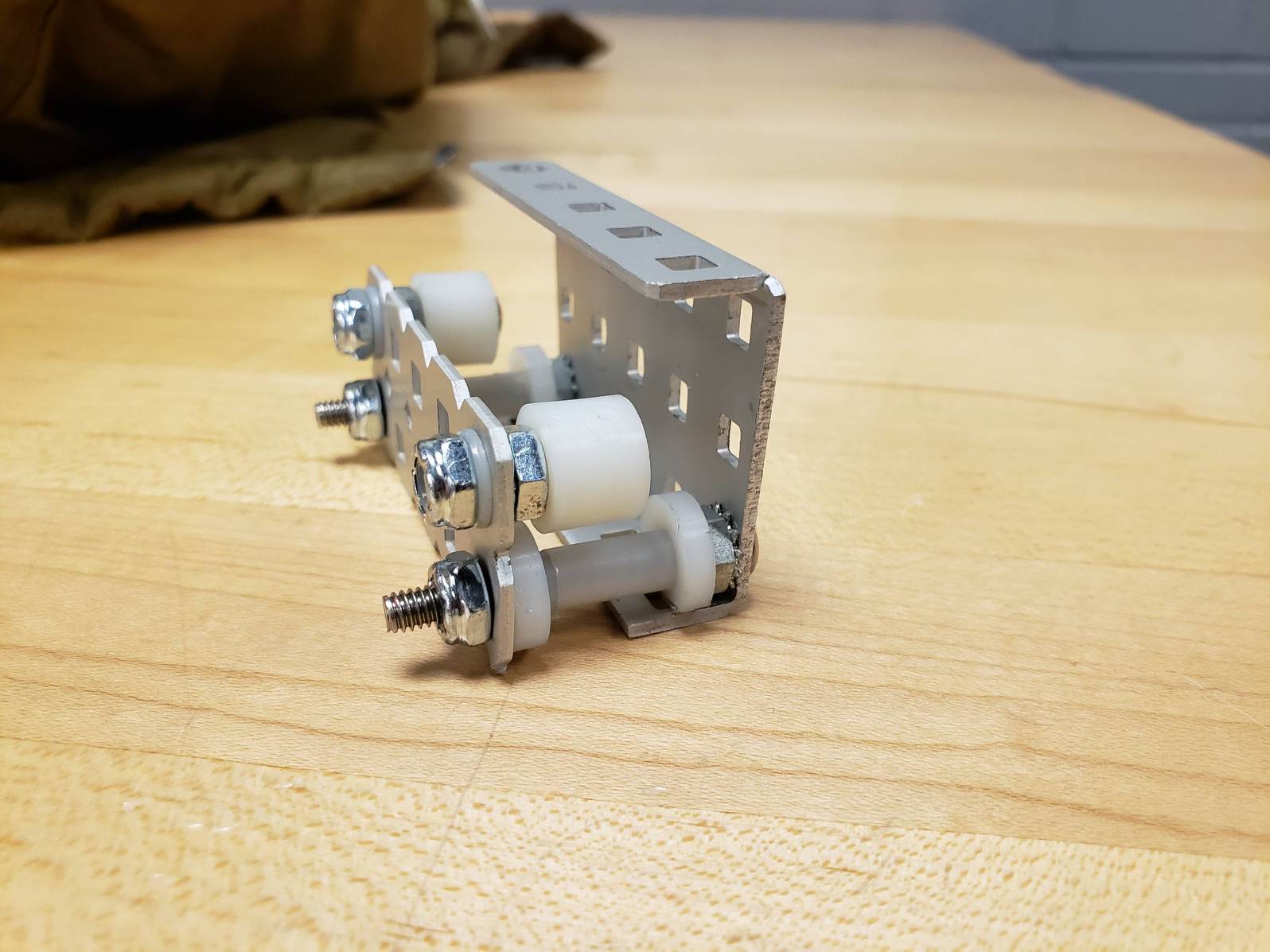

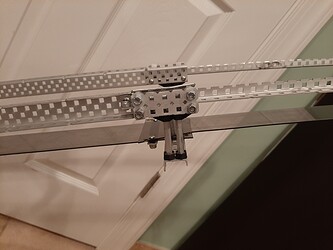

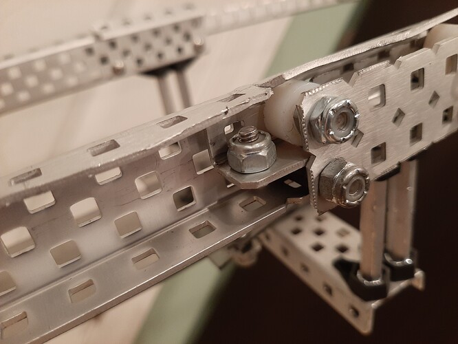

You definitely can do a telescopic tray with angle bars.
Just put these on the outside of the angle pieces and it will work fine. We just adapted that design to fit in a c-channel since we already had the tray built.
Good design, but a lot of us do not have the resources to make entire C-channels unusable for the next generation of teams. Our coach would kill us if we bent it out like that. We all are using folding trays

Not sure how true this is. Hypothetically, yes having retractable stages is not only more space efficient but also significantly easier to drive with. That being said, telescopic stages act as caps for your cube capacity. With a 2-stage plus telescopic, your limited to roughly 9-10 cubes built optimally. To push your capacity to 11-12, you’d need a 3 stage plus telescopic, which adds a significant amount of weight to the end of the tray. In that case, it can be argued that just sticking a lexan/string 4th stage on the end of a regular folding 3rd is lighter and more simple than a 3 stage + telescopic fourth. Footage from China supports this theory.
