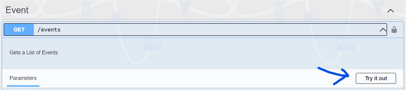

So recently, I’ve been working on a Discord bot written in C# that needs to access the robotevents API, and until now I’ve had no issues with it. I logged into the site and created an access token, and everything worked perfectly, up until today. Without changing any of the relevant code, robotevents.com suddenly stopped responding. I can still load the website in a browser perfectly fine, but my http GET request freezes up. I’m able to make a request from the API page without issue:
