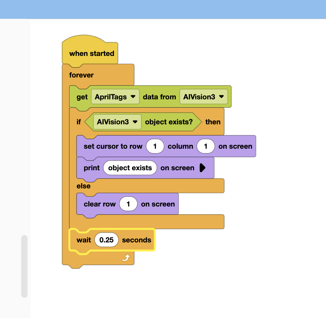

Was really excited to get this in the mail today and am training coaches from across our school district tomorrow (well, later this morning I guess) but I just can’t get the thing to work.

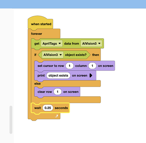

I have tried code just like is in the API, and while objects show up great in the configure dialog, I’m getting nothing when trying to run this in code.

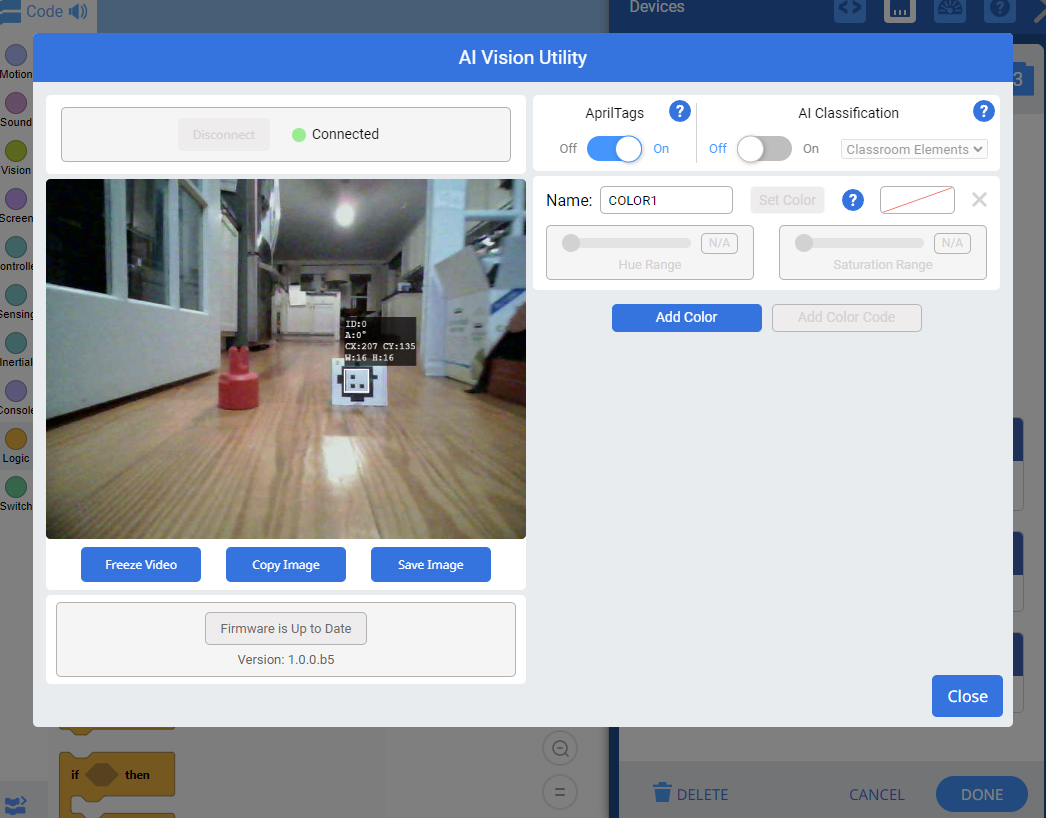

I’ve used AprilTags and colors (red like the pin, though disabled in the screenshot) and both show up instantly and consistently in the configuration screen. Then, when running the code, it doesn’t seem to detect them.
I’ve tried changing object counts, looking at variables like centerX, testing output to the console to make sure I enter the forever loop (I do), if-else statements to make sure I’m hitting the if-statement… so many things.

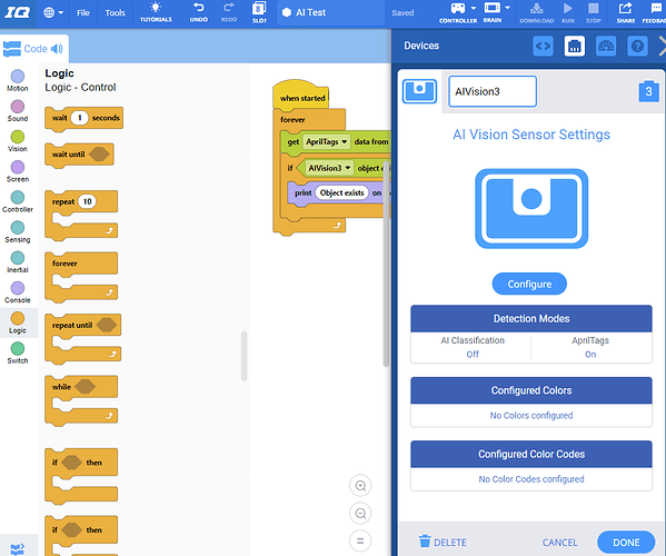

Assume you did click the “ done” button on set device setup panel
Yes- to be absolutely sure I’m not missing something silly here, in the case of AprilTags, I:
  • plugged in the sensor to a gen2 brain
  • plugged the sensor into the computer via USB
  • added the AI Vision device
  • selected the correct port
  • clicked configure
  • turned on AprilTags
  • verified they were well detected in the video feed
  • clicked close
  • clicked done
  • removed USB cable from AI Vision sensor
  • plugged USB cable into remote connected to robot brain via Bluetooth
  • downloaded code, and
  • ran code
idk, I did a quick check with this similar code and all works as expected.
This was using web based VEXcode. IQ2 brain must be on vexos 1.0.9
Brain was 1.08- VEXcode IQ said it was up to date and that the brain was up to date at 1.08- firmware update forced through the web app fixed it and now our little clawbot follows our kid holding an AprilTag around the room. Thanks!
Hm, VEXcode not forcing an update is a cache issue and known bug, I’m surprised trying to use the AI Vision API didn’t crash the brain.
