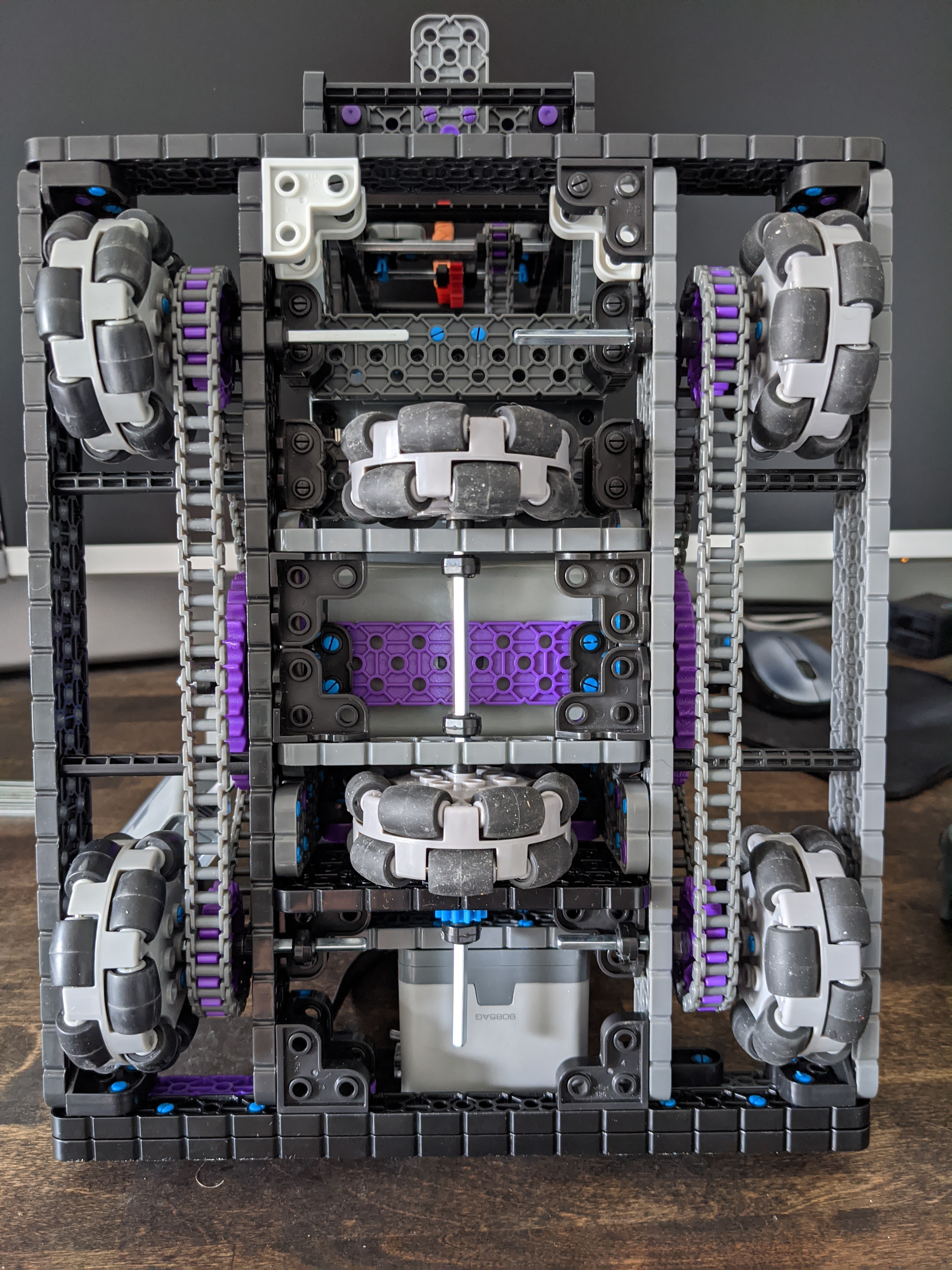

PXL_20201017_163345581
Here’s a picture of the bottom, nice guess work on the h drive with two wheels, you definitely can’t see that from the pictures. The thought process was two wheels for the h drive would give us greater power and grip versus one when going side to side and it does feel better with two wheels than one based on some tests we did before. But if the two wheels are that big of a difference in affecting turning, might have to drop one.

It was the video that gave away the two wheel H-Drive. Nice work overall on the drivetrain. Try removing the H-Drive and seeing how it performs, just as a test, and then you can figure out what works for you, 2 wheels on the H-Drive, 1, or none.

Just to close this off, the issue with turning was because of using the two wheels for the h drive. Going back down to one wheel for the h drive worked to restore turbo. Thanks!
