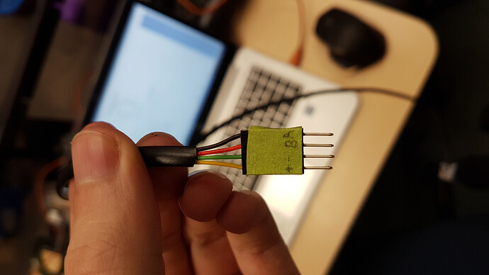

Black: RS485-A
Red: RS485-B
Green: GND
Yellow: Power(12V)
Hardware 硬件
First of all, we need to buy an RS485 to TTL module in order to change the A and B lines of RS485 represented by the black and red lines of VEX to UART level, and connect the A and B lines and GND on the right side.
首先我们需要购买RS485转TTL模块,将VEX的黑和红线所代表的RS485的A和B线变为UART电平,把A和B线还有GND在右侧接上。
Then buy a 12V to 5V step-down module to power the Arduino. Connect GND and VIN to VEX’s GND and Power, connect GND and Vout to Arduino’s GND and VCC (5V)
然后购买12V转5V降压模块,来给Arduino供电。将GND和VIN连接VEX的GND和Power,将GND和Vout连接Arduino的GND和VCC(5V)
I made a pcb board to allow the VEX to plug into a breadboard and bring out the pins.
我制作了一个pcb板来让VEX能够插在面包板上,引出各引脚。
