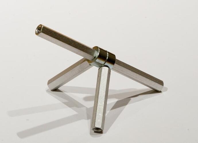

I was mounting an ultrasonic sensor in the robot I’m slowly building for tutorial purposes today. Rather than just cut a piece of Aluminum or make a bracket, I was looking for a simple way of doing this and ended up with the following.
Half inch standoff, shaft collar with set screw removed, three 8-32 screws and two washers.
This started me thinking about other ways the shaft collar could be used and I remembered this post.
So I put together this.
Now I remember that Jordan (I think) had an interesting way of joining two shafts using lock bars, standoffs and collars. What other interesting and unconventional ways of using VEX parts in a not so obvious way has anyone come up with?

A few of our teams have used the standoff to collar method quite frequently as a triangular support. It really is a great way of getting just the right angle and not using much weight or space like a full bar would.

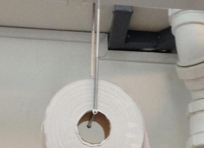

My boys constructed a toilet paper holder in the lab…
