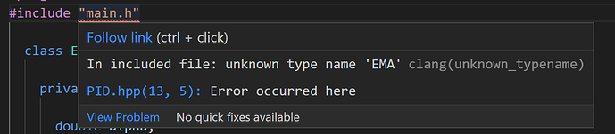

Unknown type name 'class'
Hey Im running into this issue that says unknown type name 'EMA'
I’m trying to create a new EMA for each PID I make, here’s the code.
EMA.hpp
PID.hpp
There error says its occuring in PID.hpp on the same line as EMA ema;
It’s also underlining #include “main.h” as an error. Could there be something wrong in that file?
What does it say when you hover over "main.h"?
na thats an extension theres no problem with that
Could you share what is on line 13 in PID.hpp?
Try removing #include "main.h" from PID.hpp.
PID.hpp doesnt use anything that comes from main, I just had it there to check if it did for some reason. So it didnt change anything
Try adding class EMA; right above class PID {.
class EMA is declared in EMA.hpp already, it cant be declared twice.
It seems like it’s not including properly. I’m not sure how to fix this issue.

Probably easier if you paste your code rather than take screen-grabs. Offhand, it looks like there is no space between #include and "7157X/motionAlgs/EMA.hpp" try adding a space there.
Yeah your right, i actually didnt catch there wasnt a space but it didnt seem to change anything still…
Heres all of the code.

I actually just figure out the issue, I had the extra #include “main.h” in my header file which really wasnt necessary thanks for all the help
