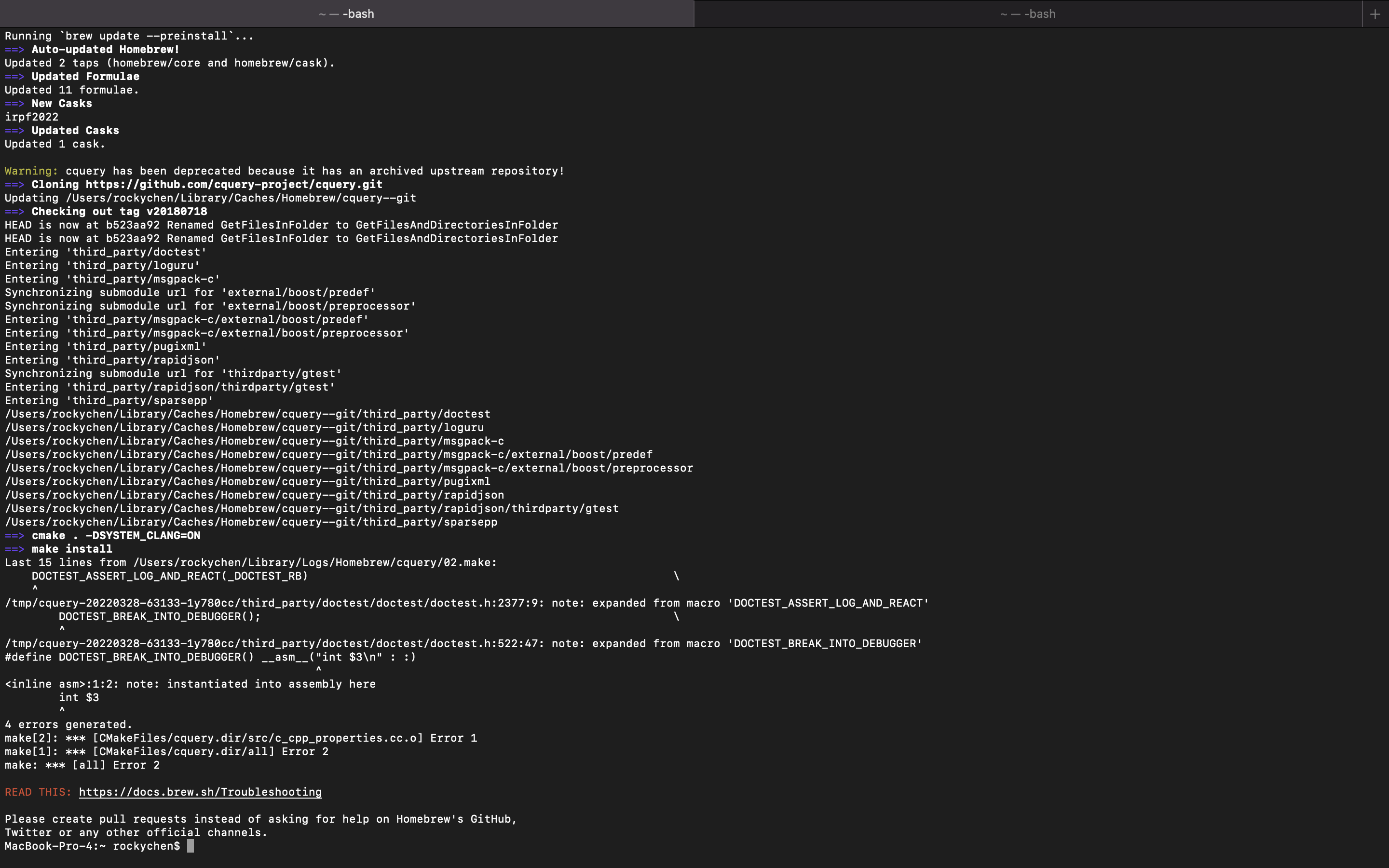

Does anyone know how to install cquery on M1? Or other ways to install PROs on M1.
Without cquery I can not use PROs on my mac.

yeah this is an issue. cquery is only currently a hard requirement for the PROS Editor which we are in the process of sunsetting. In the meantime you can justbrew install pros-cli and then bring your own editor. We have plugin support for Atom (no longer receiving updates) and VS Code (in development), so either of those are good options
I currently use PROS on my M1 MacBook Pro in VS Code with the plugin. Works great
