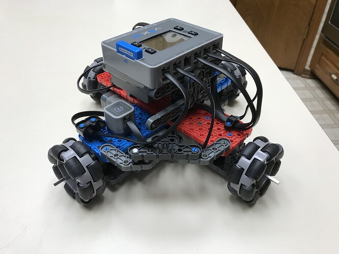

I wanted to experiment with omni wheels. After reading several posts, it appeared that the most interesting approach was to orient the wheels in an X pattern. I have now built XWing4Omni, and have written a program to demonstrate several of the possible movement patterns.

Here is what the bot looks like:

I am pretty impressed with the precision and repeatability of the movements. If I move forward, then backward, I pretty much end up in the same spot. Not bad!

The movement modes include:
  1. move straight forward or backward
  2. strafe right or left
  3. upper right 45 or lower left 45
  4. rotate right or rotate left around the midpoint between the right two wheels
  5. spin right or left
  6. rotate right of left around the midpoint between the rear two wheels
  7. upper left 45 or lower right 45
And more/different modes are possible, since each wheel can spin forward, reverse, or stop.
And yes, I suspect the bot moves at different speeds, depending on the mode. For example, it is quite good at spinning around. Not so fast at moving straight or strafing. It is pretty good at moving at a 45. The more wheels that are spinning the same direction, the faster it moves. It is fairly complex, which makes it interesting.

Yes, this is an inherent property of x-drives. This page gives a good overview of why that is.

Lots of holonomic drives exist for edr, this isn’t anything new.
^^^ tons of x-drives out there already. Doesn’t make much sense tho for tower takeover. X drives take up a lot of space, so making a cube tube x-drive is nearly impossible if you still want to fit two cubes in the large zone. X-drive trays are viable, but also pretty hard to fit. There’s also a loss in torque with this configuration.
