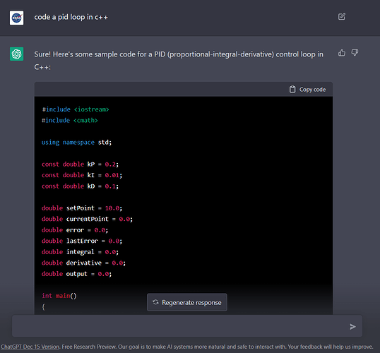

For fun, I asked it to write a PID loop in C++, here’s what it spit out:
The actual code:
#include <iostream>
#include <cmath>
using namespace std;
const double kP = 0.2;
const double kI = 0.01;
const double kD = 0.1;
double setPoint = 10.0;
double currentPoint = 0.0;
double error = 0.0;
double lastError = 0.0;
double integral = 0.0;
double derivative = 0.0;
double output = 0.0;
int main()
  while (true) // loop indefinitely
    // calculate error
    error = setPoint - currentPoint;
    // calculate integral
    integral += error;
    // calculate derivative
    derivative = error - lastError;
    // calculate output
    output = kP * error + kI * integral + kD * derivative;
    // remember error for next iteration
    lastError = error;
    // set the output (e.g. control a motor)
    // update current point (e.g. read from a sensor)
  return 0;
It even added a lot of important context as to how the code operates after it wrote the code without me asking it to
"This code will continuously calculate and update the output of the PID control loop based on the current error between the set point and the current point. The constants kP, kI, and kD are the gain constants for the proportional, integral, and derivative terms, respectively. You can adjust these constants to tune the behavior of the control loop.
Note that this is just sample code, and you will need to modify it to suit your specific use case. For example, you will need to provide code to set the output (e.g. control a motor) and update the current point (e.g. read from a sensor).
I hope this helps! Let me know if you have any questions."
Mind you, this isn’t a copy-paste solution. You still have to implement it correctly and tune it (for example, this is missing integral bounds to prevent integral windup) but it was able to provide a very solid foundation. I think this is a powerful tool and I’m curious to see what other examples other people come up with

You can also have the AI write a PID loop in PROS to control a motor. It will set up all the pros functions, define the motors, and even put it in a task when asked to. When I did this though, I had to correct mistakes it made.
This was one such mistake. When I told it that it forgot to add this, the AI went back and rewrote it to include code to prevent integral windup, letting me know that was the correct thing to do.
