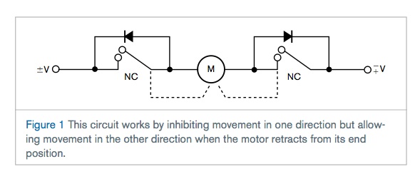

Let’s do this: Imagine I just have the 12v battery, voltage converter and power leads to the motor on the linear rack.
pos > pos and neg>neg makes the motor go up the rack
Reversing the polarity brings it down.
Let’s apply that basic function and add a Vex limit switch to the top and bottom.
That’s what I need to understand first :slight_smile:
https://vexforum.com/attachment.php?attachmentid=4879&stc=1&d=1322688875
Enjoy :slight_smile:

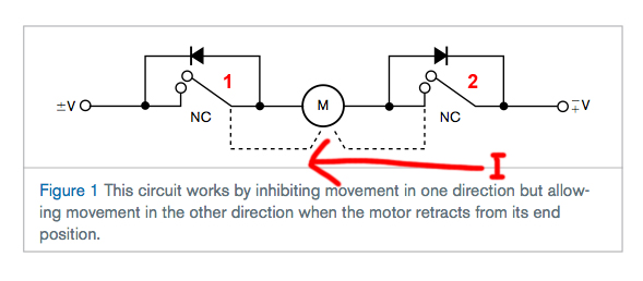

Ah, ok…can you elaborate on that beautiful schematic?
https://vexforum.com/attachment.php?attachmentid=4882&stc=1&d=1322690355
Say the current is flowing in the direction of the red arrow, the motor will turn. When the limit switch is reached (switch 2 in this case) it will open and break the circuit, now the motor will stop. If the battery is reversed then current will flow in the opposite direction, the diode over switch 2 will allow this. Limit switch 2 will now close again. Same happens for the other end. This is an old and crude way of achieving what you want. A better way is having the limit switches work with the H-Bridge in the motor controller directly but neither the VEX part or (as far as I can tell) the dimension engineering controller allow this. There are other controllers on the market that have limit switch inputs but the ones I have used in the past now seem to be discontinued and were also very expensive.

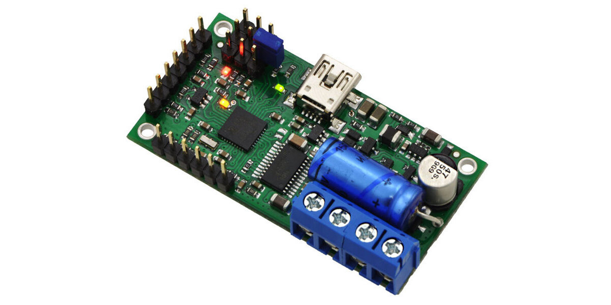

How about a controller like this?
The Resources tab has a good deal of information too.

First you say “no controller, just wires”
Now you suggest a USB connected smart controller from pololu,
which is wired just like post #8 again (connect the limit switches to the controller, not the motors).
The pololu solution looks like it has a bunch of nice features.
You don’t need a diode on the limit switches if you use the pololu, and program correctly.
