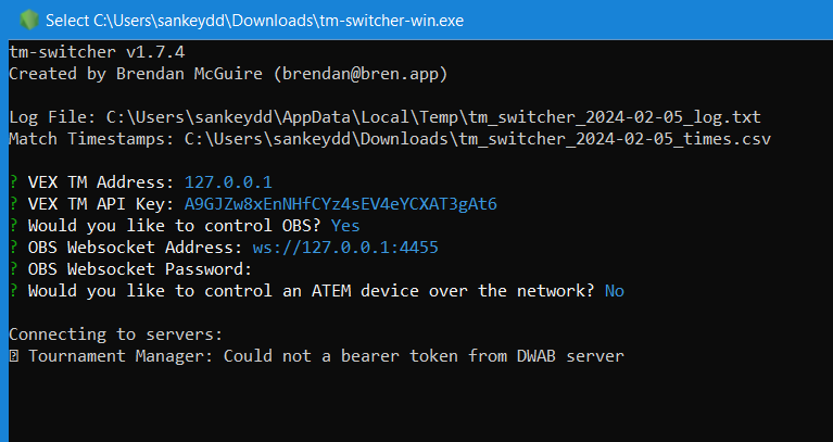

Now I’m seeing this???
@brendanmcguire might have a different solution but my guess would be that you need to add the port to the VEX TM Address. Iirc, the switcher defaults to 80, but if yours is 8080 or 5000, you need to specify that.
I kept getting “Tournament Manager Web Server returned non-200 status code”
The switcher has to reach out to DWAB’s server to obtain credentials. This means that the device you’re running the switcher on could not connect to the Internet (DWAB’s server)
Thanks. Will it have to do that each time or just once?
At least once every couple hours right now, but the time that the token lasts isn’t set in stone and can be changed by DWAB at any time.
