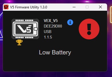

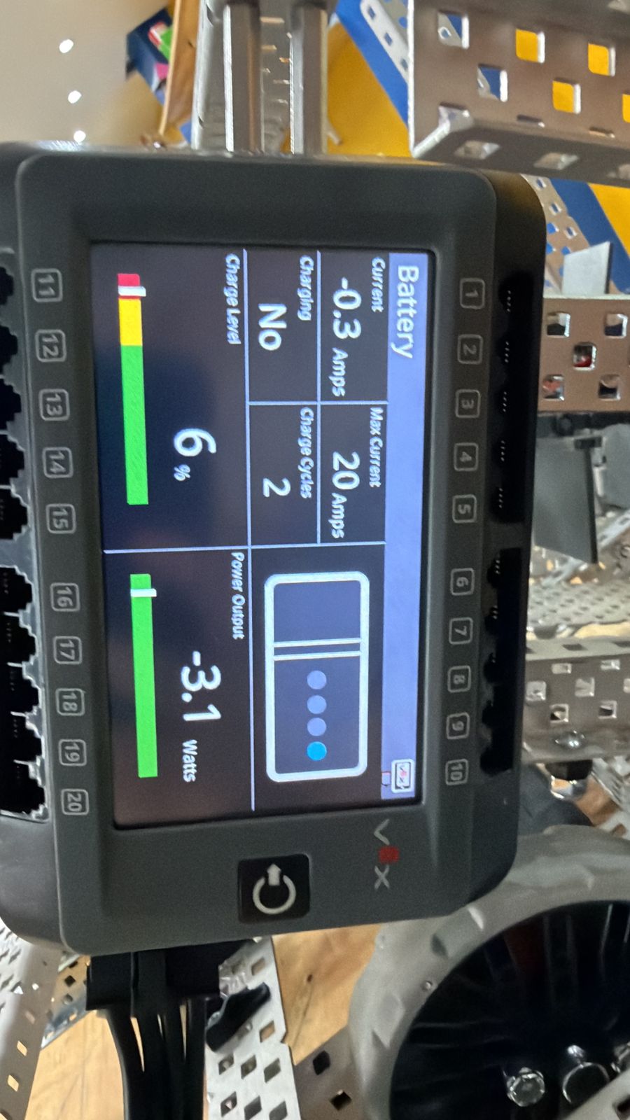

Our V5 battery won’t charge. When we plug it in, the green light stays on for a few seconds, then turns red. It’s a new battery and has only been used twice. What could be the issue?
use this
https://kb.vex.com/hc/en-us/articles/360035590212-Using-the-V5-Battery-Medic
post another screen shot.

This is what I see.
Did you follow all instructions including this part ?
Hold down the Shift and v keys on the computer’s keyboard and then click the V5 icon on the V5 Firmware Utility with your mouse. The icon is highlighted above in a red rectangle.
