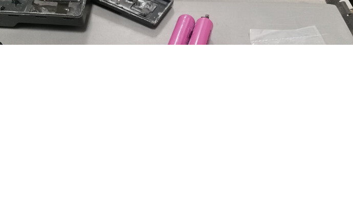

Are V5 batteries dry or wet cell batteries?
V5 batteries contain four lithium Iron Phosphate(LiFePO4) cells which are dry cells.
Image below of the cells was taken by u/meepmeepme
Wet cells are full of liquid, like your car battery. There’s also a battery called a gel cell, which is kind of in-between.
