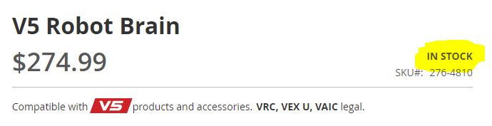

V5 Brain appears to be back in stock.
https://www.vexrobotics.com/catalog/product/view/id/1868/s/276-7000/
Is this out of stock?
at top of that product page it says "Ships by June 30th

I was responding to the V5 System Bundle question.
