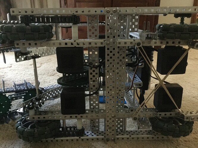

Recently, I’ve had issues with my drivetrain where my robot will slowly come to a halt when turning. We’ve tried swapping out the motors and changing the ports however that doesn’t seem to be doing anything. The programmers also claim that the code should be fine as well. Has anyone else had this issue and if so, how’d you solve this?
Can you show a picture of your drivetrain?
You need to be more specific. Post pictures of your drive train as well as your code. What you’re describing to me now seems like a friction issue and mass imbalance.
This is a bit of an old photo but somewhat the same besides that the motors are now connected directly to the wheel

Your wheels look really close to that C-channel. Is there a spacer in between them? If the wheels are rubbing against the metal it will make them hard to turn. Same thing with the sprockets.
Nah, the c channels aren’t touching the wheels and they can spin freely when not connected to the motor. A direct drive also didnt fix the problem either. We haven’t checked the code yet tho

I used to think that as well but did some testing awhile back and found that the current draw on the motors was greater if the drive was longer than it was wide.
My drive currently is 25 wide and 30 long. The front wheels are just behind the chassis and my back wheels stick out from the chassis. I’m also using 200rpm cartridges.
