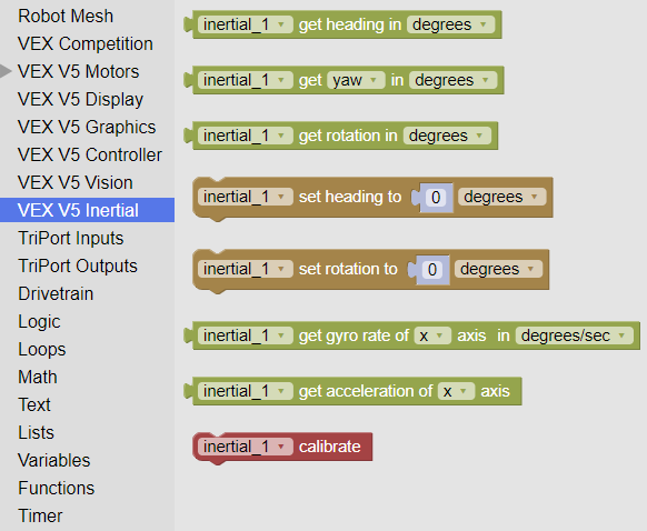

The new V5 Inertial Sensor is now supported in Robot Mesh Studio programming online at https://www.robotmesh.com/studio
New Blockly blocks:

Awesome. And there is a Calibrate block too! Are there any release notes for this version? There are couple of fixes I am waiting for.
