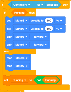

How do you make a toggle? LIke, press the button once to start a motor spinning, and press the same button again to stop. I haven’t figured out how to do that.
Toggles can be done with Events (aka ‘When’ in Blocks). They fire once each time you press and release a button.

Can I put an If statement around the whole thing saying that x was pressed, due to competition code and the fact that it has to be in one long list of code?
(Inside my code)
Screen Shot 2023-03-28 at 2.26.12 PM
It does not need to be in a single long list of code, that would be difficult to navigate at least for me. You can multithread (use multiple “when driver control” hat blocks), and the code shown by Hudsonville_Robotics would work fine in a competition bot, as long as you don’t press the trigger during autonomous. I am not sure if the field control automatically disables the controller during auton period, but if you would like to avoid an accidental autonomous-control activation, you could code the bot to disable the controller until driver control starts. However, the code you showed would work fine, just wouldn’t be the main choice for lots of people I’ve met.
It doesn’t have to be in one long list of code. The advantage of events is that they separate the responsibilities of the code. The competition template knows how to handle events too.

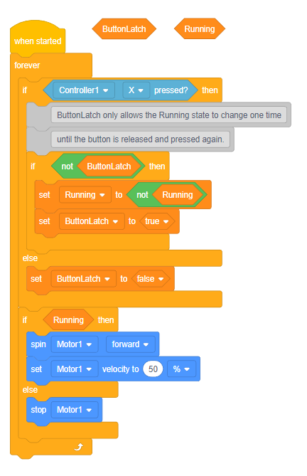

If you don’t want to use events, then you need to add a latching variable. Events fire one time for each button press. If you are using an in-line if statement, the code fires once for every loop. This means that your code would repeat on - off - on - off when you held the button down. The latch adds an extra layer that locks the state after it has changed one time.
This is an example of an in-line toggle.
That’s interesting. I’m really not a coder, we had a coder last year but he went to another team, and I was willing to try it. I was told by the rest of my team that hat blocks wouldn’t work in driver control at all. I’ll seperate the code and try it in the future
