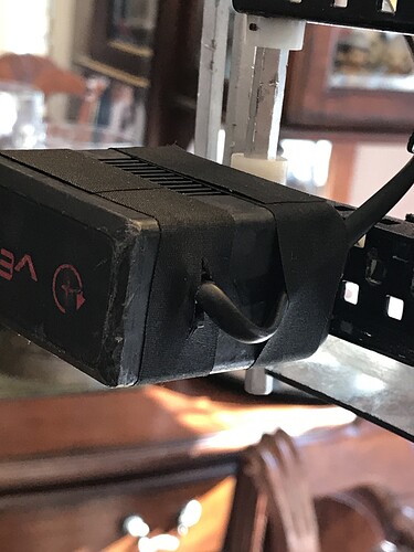

    I found most of my problems occured because of static. Cut a slit in electric tape and push the motors V5 wire through the slit. Plug the V5 wire into the motor and wrap the electric tape around the motor. This should help protect the port from static charge entering the motor and breaking the internals and/or port on the brain. After competing in 2 competitions, both with different referees, I never got stopped and told to take the electric tape off during inspections, and I never broke a motor or motor port since I made the change.
Not sure this is a way of eliminating electro static discharge, but from inspection purposes the tape is used for wire management.
