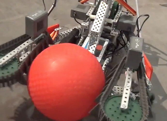

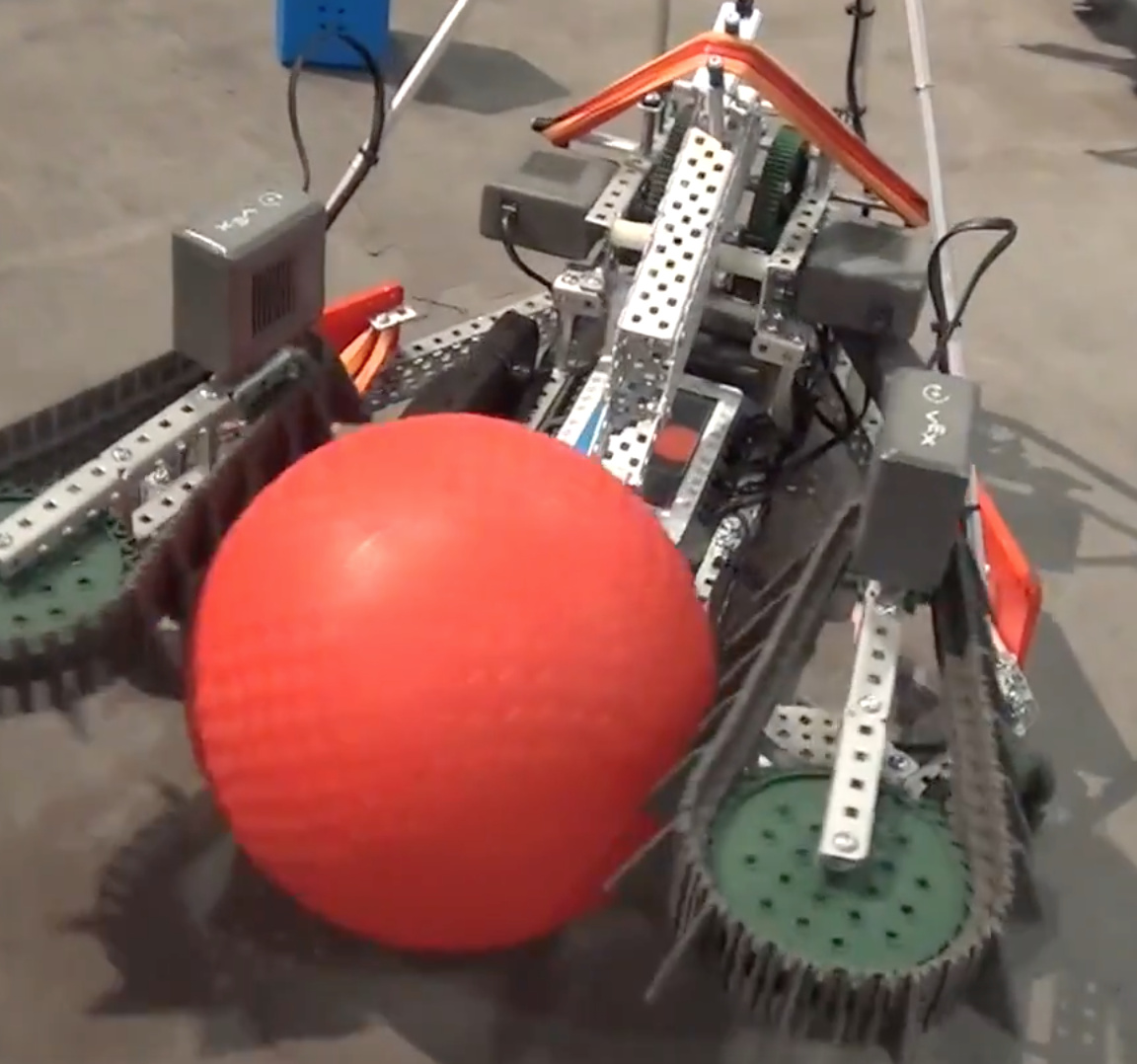

Oh, I see. Looked at the wrong thing then… :smiley: Woops!
But what’s the big thing directly opposite the battery? Same mounting location, just on the right. That’s what I thought he was saying the radio was, and that’s what had me worried… :smiley:
Nothing mounted in the same location but on the opposite side. Here’s a screen shot from the video:
Not sure why the picture @Max_Johnson03 included looks that way.
Edit:
Watch a few seconds of video from the 1:00 point; it’s clear nothing is attached in the “mirrored” position to the battery.
You may have to change playback speed to .25 to really satisfy yourself, but you can tell nothing is mounted opposite the battery.
