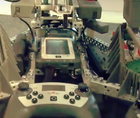

#16
I believe the blocks on both sides of V5 are batteries
#17
Each of these robots has one battery. The larger bot has its battery on the left as you look at it from the front. What you may think is a battery on the right is the new V5 radio (replaces VEXnet keys).
#18
Is that screenshot from the video? In the video I can tell that
VEX 02
only has one battery, but in the picture you attached it’s hard to tell.
Edit: Tried to delete duplicate post but it deleted both duplicate posts. This is the repost. I also agree with @Rick TYler
#19
If that’s the radio, that’s going to be a pain! That’s huge!
#20
It is not that big. It can be connected with any length wire to any smart port on the brain.
