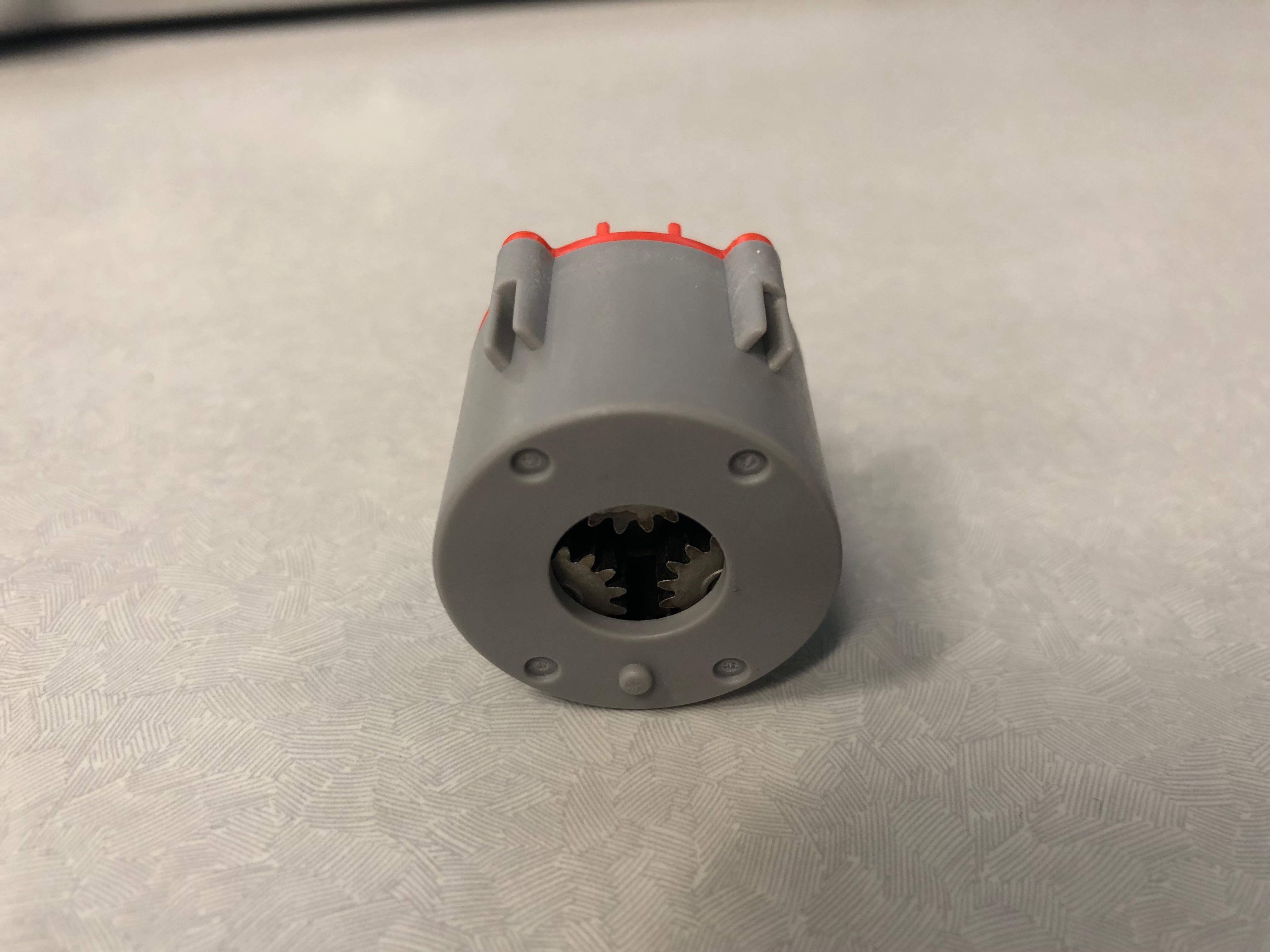

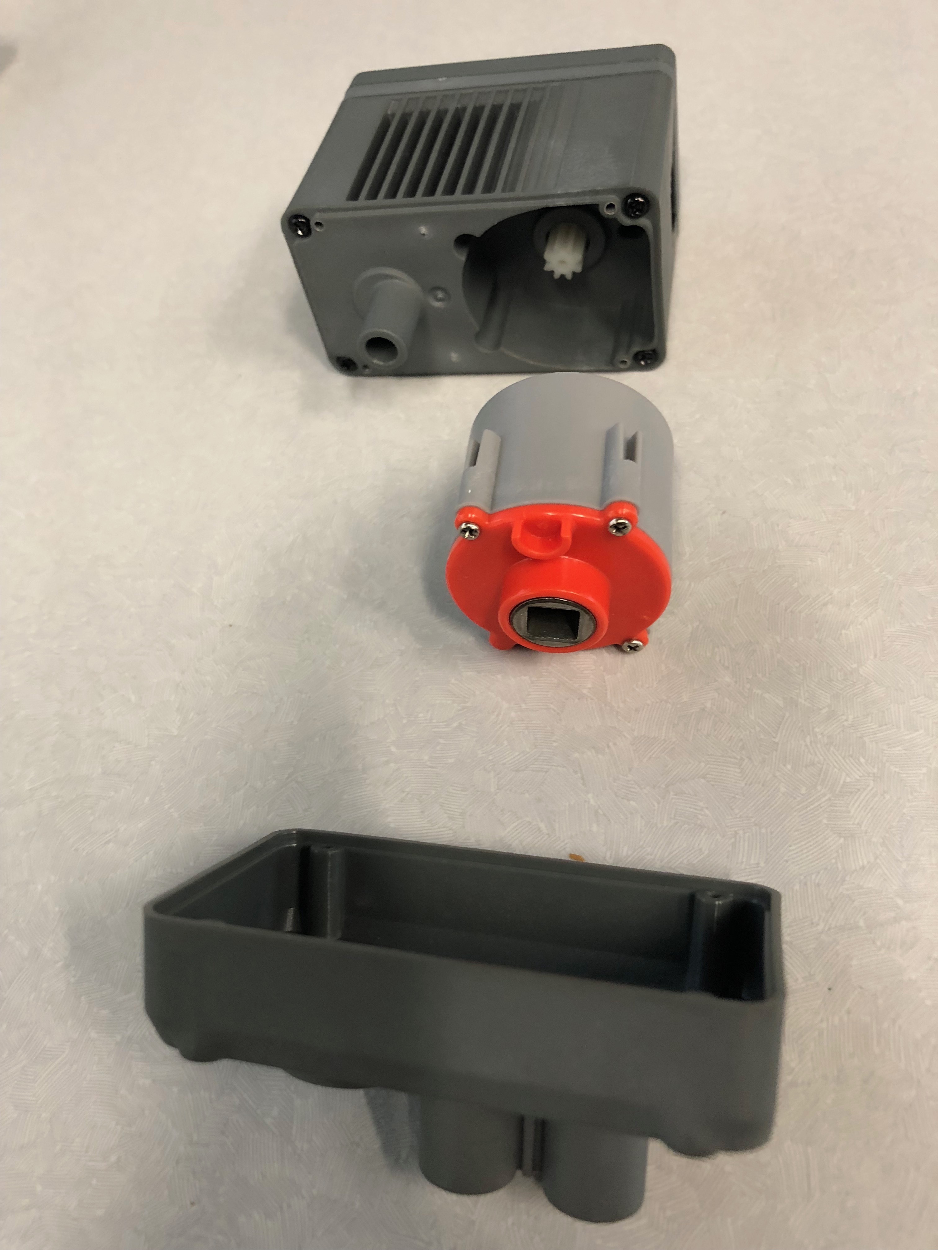

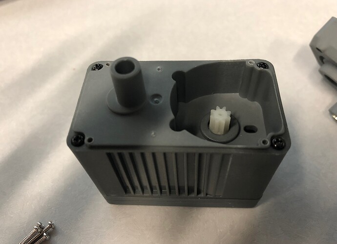

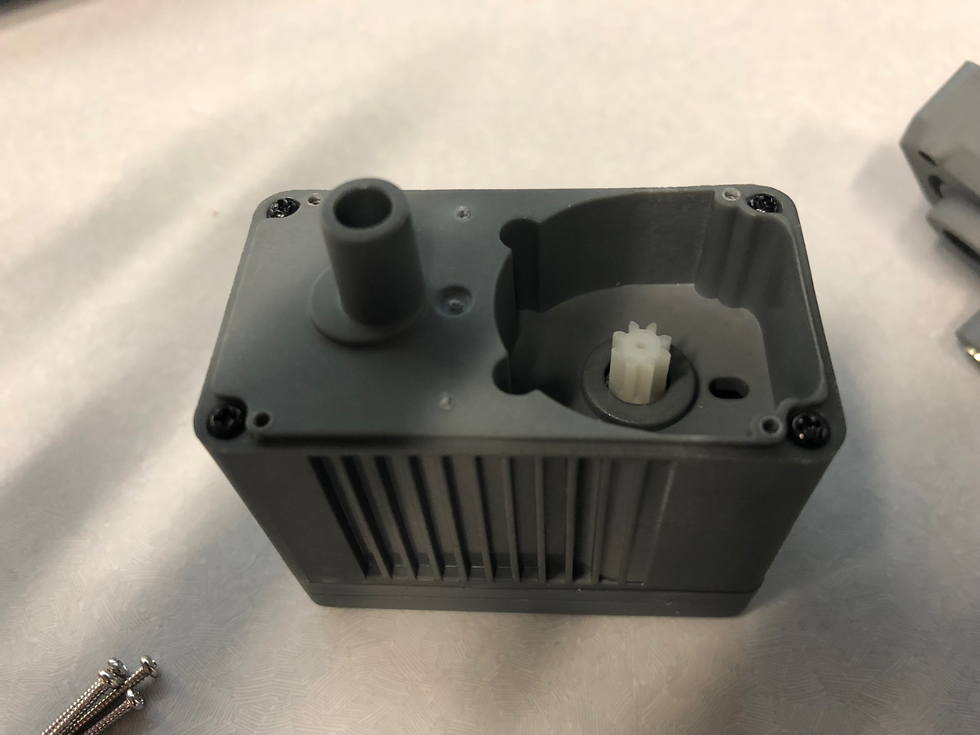

  3. The motors are significantly more robust than the 393 motors. The 393 motors were designed during a time when teams were using much less power and the robots were not all that demanding. Over the last 8 years the motors have just been pushed beyond what we ever thought they would. We did not make that same mistake on the V5 motor. Here are some attached pics. You can see that the
    “cartridge” is a 2 stage planetary gearbox and is fully assembled. There will be three cartridges: 100 RPM, 200 RPM, and 600 RPM. The 100 RPM will be in the stock motors. The 200 and 600 will be add-on cartridges that you can purchase. No more grease on your hands from changing gears.
The encoder and motor controller are completely isolated from the planetary gearbox on the back side of the motor. Cables are separate so motors don’t have an integrated cable to go bad. Since these are smart motors, we are using the V5 firmware to monitor everything. we even have a motor life monitor that tells you when you are getting near the motor life based on mean current draw and motor rotations. Our goal for this motor was it would fail when the brushes fail, which is the end of life for motors. we expect teams will have to buy significantly less motors than in the past so your total spend on motors should go down over the long haul.

No wonder they’re so big and expensive, that’s a lot of stuff to fit in a motor! It sounds like it should be well worth the money though! Having a “gauge” for the motor life sounds like an especially nice feature to have :slight_smile:
Not having to tear apart the motor to change the speeds will also be a nice feature(one that wasn’t needed but will be very nice to have).
600 rpm is going to be really nice though! That’s going to be crazy fast for any mechansim. Should make the game really interesting though now that you’re giving us more options to speed things up.
@Paul Copioli 200 rpm to 600 rpm is a pretty significant jump. Is vex planning on offering more options in between in the future?

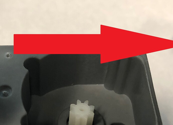

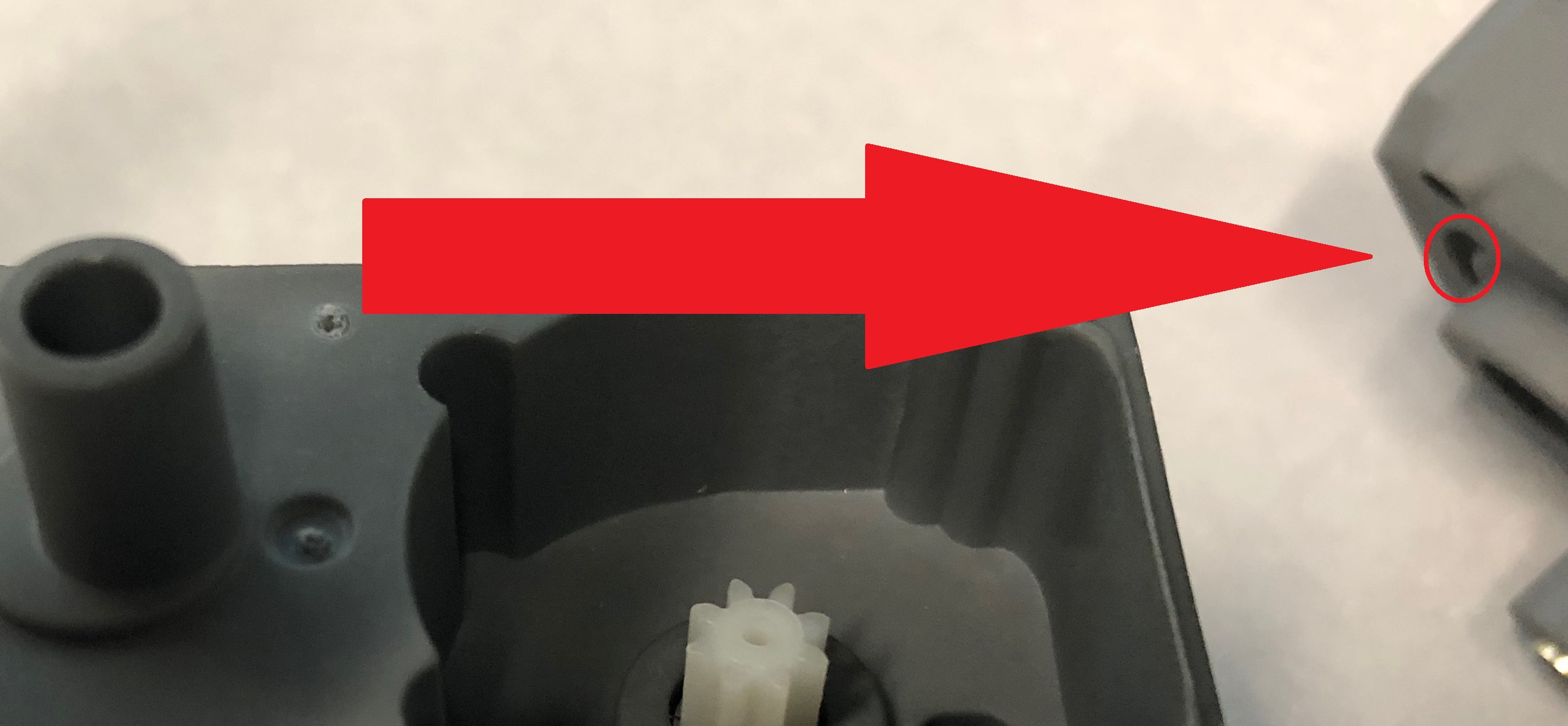

Is that a gearbox window I see!?
NO MORE GEARBOX GUESSING!
I assumed they were gonna be color coded.
