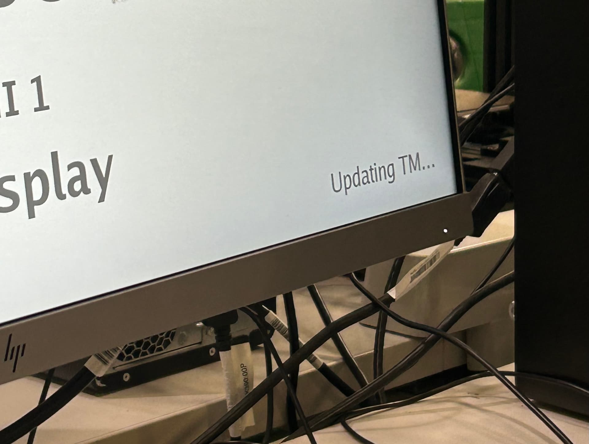

The Robotics Coach is receiving this error message (updating TM) when attempting to connect the screens to start a match. All of the screens are on the same network and will connect to change the name on displays. Any guidance on how to maneuver this would be appreciated.
Are the Pis connected through ethernet or through Wifi? If wifi, I suggest trying a hardwired connection.
Have the Pis been reimaged with the latest SD card image? If not, I suggest reimaging the SD cards. The Raspberry Pi Imager utility works really well and will give you the TM Pi image as an option directly from the program.
