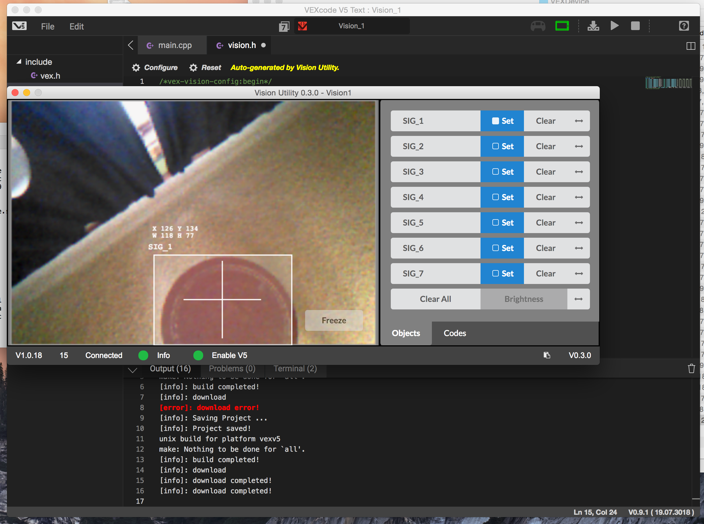

Can you verify that;
The Vision Utility can connect to the vision sensor and display a live image
post the sensor firmware version from bottom left hand corner of the vision utility window in this topic.
can you set a single signature (one simple colored object) and read that in a small program.

Ok, lets check one more thing.
Open vision utility and set one signature.
Then press and hold down shift+option (or shift+alt on windows I think) and a new control will display on the status bar that says “enable V5”, select that so it turns on. The update rate will now drop to about 2 frames per second. Do you still see the object you selected and set a signature for shown with a rectangle around it ? If you do we need to continue debugging. If you do not then this vision sensor really is locked and you need to contact vex support and get it replaced. Let me know what happens.

When I do the “Enable V5”, it still shows my item in the window with the tracking rectangle around it.

vexos 1.0.8 has a bug. We are displaying this alert when not needed. It will be fixed in 1.0.9, but for now just clear the alert, it has no impact on user programs. Sorry for the inconvenience.
