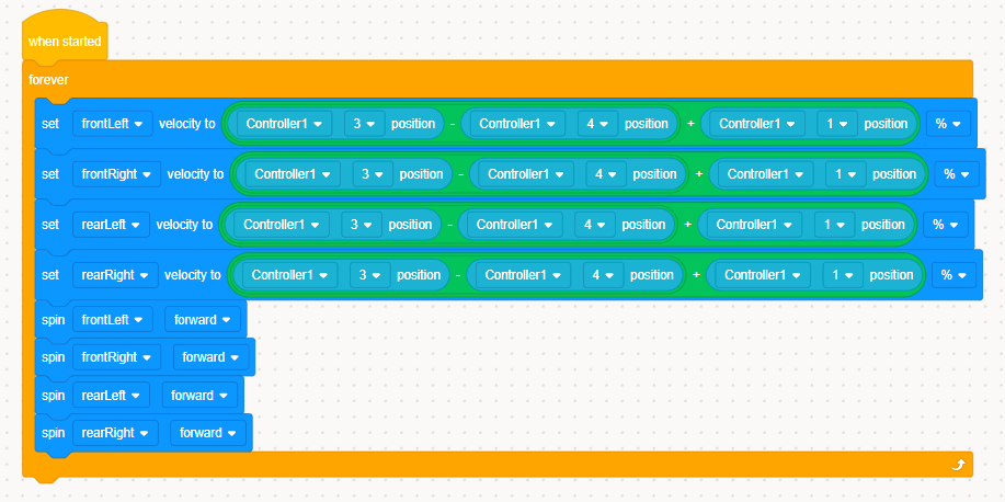

i need a xdrive v5 code file preferably in vex code text ill change my wiring to what ever u have just i need help with a code that controls movement on one stick and rotation on another please

So, the front left wheel… When Ch3 is positive (up), then the motor should move forward. When channel 4 is positive (right), the front left wheel will also move forward. Finally, look at channel 1. When channel 1 is positive, (left) the bot will spin clockwise, so the front left wheel will be positive again.
So frontLeft should really be Ch3 + Ch4 + Ch1. Every wheel will be the sum or difference of these three channels. I assume your bot is built, so you can grab your bot and move it around to see what direction the wheels will turn when you press your stick in the desired direction.
The following is NOT correct, but gives you an idea of what to do.
