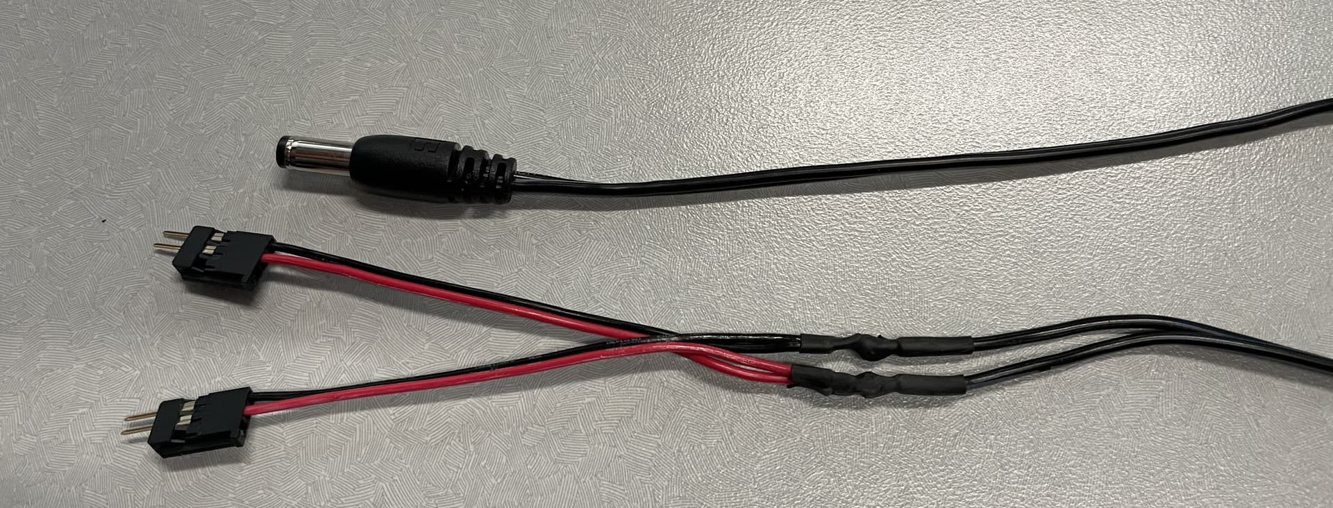

I have Jetson with the depth camera already, and just need the VEX 3-Wire Connector to Barrel Plug Cable: to power the Jetson via the V5 Brain. Can someone help me where to get this cable ? I can’t seem to order it from the Vex website.
I don’t believe it is separately available, maybe @mbeem can confirm.
It should be very easy to make yourself though, or as a (higher power) alternative you could power the jetson off a 5v battery bank or with some custom electronics, off a smart port.
From the picture, it looks like two 2-wire cables fused with a barrel plug cable. Can I simply connect the red wires from the 2x 2-wire cable to the red wire of the barrel plug, and do the same for the black wires?
That seems right, you would probably want to double check the polarity before plugging in the jetson nano though.
I will say again though that this is not an ideal way to power the jetson, the ADI ports are quite limited in the power they can supply, and the jetson actually has to throttle its performance when running off of the ADI. You would probably be better off with a USB battery bank or a voltage regulator off a smart port.
We achieved about 5min runtime with the V5 powering a robot and the Jetson Nano + cameras. Use a separate power source for the Nano and then you don’t need to run it in power limited mode either.
I can go digging the AI archives here and find this cable to confirm but it’s literally just the red and black wires from 2x 3-wire ports paralleled together and wired into a DC plug. Total current available from the 8x 3-wire ports is 2A @ 5V so you’re drawing 1A from each of the 2 ports using this adapter cable.

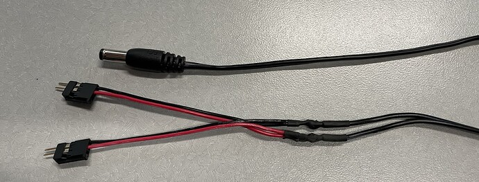

The custom cable is pretty simple. The 3-wire connector side is just that. The white wire and contact was removed. Under the heat shrink tube, it’s red + red + tip of the barrel connector wire. And, black + black + the outside of the barrel connector wire.
As mentioned above, the custom cable can power the Jetson from the 3-wire ports
, but using an external battery can give you more run time.
