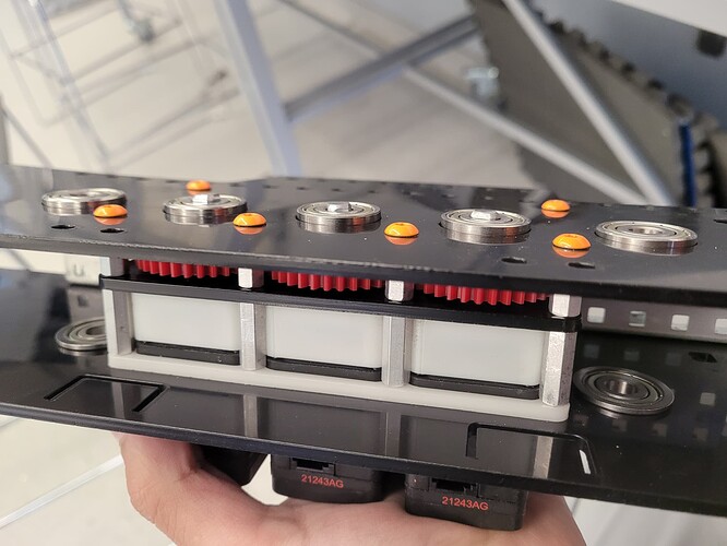

On the build side of things, this year raised new challenges for our designs. Fitting into size constraints is challenging, especially when you’re packing on a Clippard air tank, Jetson Nano, battery pack, two Intel Realsense cameras, and a bunch of cables.

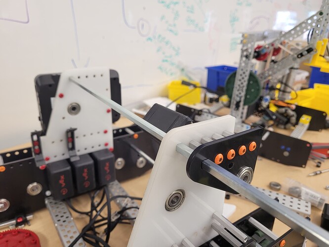

Our 24" robot makes use of 14 laser cut and 3D printed parts throughout its build. At its core: an 8 motor X drive. This drive makes no compromise between strength and speed, resulting in a robust and flexible platform for code and experimentation. The wheels are Vex Pro omni-wheels to handle the unusual forces of an X drive under such weight. This robot is capable of scoring rings using a wide intake for margin of error with object detection.

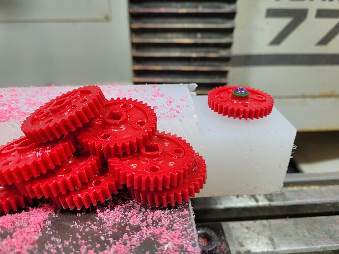

Our 15" robot required us to get a little creative to make space. This year, we made use of 3D printing, laser cutting, and CNC milling across both robots to reduce size and increase functionality. Featuring custom milled gears, low profile motor mounts, ball bearings, drive sides under 3.2" wide, over 41 total custom parts and 221 total design revisions, our CAD can be found using this link!

Which type of plastic are you using on the x-drive gear assembly?
The plastic used across both robots is 1/8" Delrin (excluding 1/4" Delrin on the lift). Delrin has a very low friction coefficient and is pretty easy to machine.
